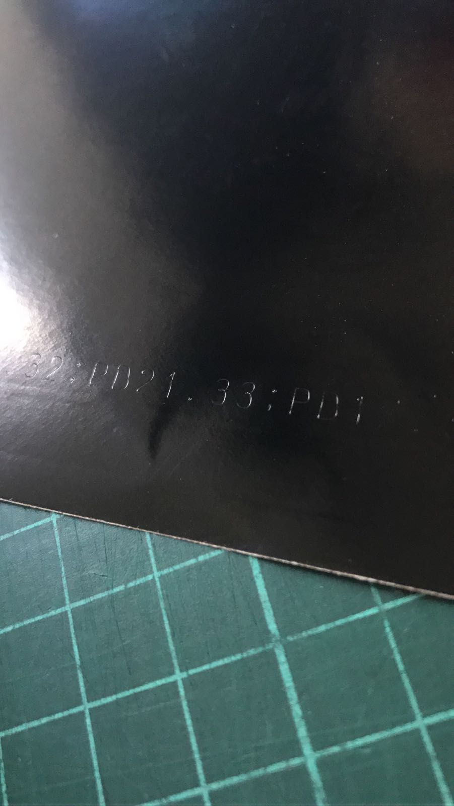

When i send something to cut these numbers and letters cut on the material. Any ideas on the problem?

Does it cut the job, or just that? Looks like your cutting program is sending a job number or something. Check it for something that's checked that shouldn't be.

Graphtec made their own communication language called GP-GL and it works with the software that comes with the Graphtec. If you are using any software that isn't Graphtec branded , like Flexi, you have to go into the cutter's menus and change the communication language to HP-GL which is a more universal language.
