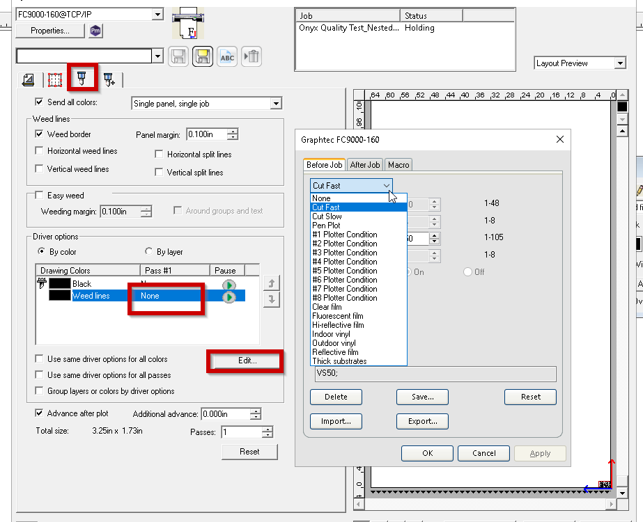

Joe House
Sign Equipment Technician
In the cut/plot dialog box, go to the options tab and see what the pass settings are. If you've got the plotter all dialed in for the material, you should set this to "None". If it's not set to none, select it and hit the edit button and pick it from the list. (Bonus tip: I also use this to run kiss cut and perf cut passes in the same plot. Just set up 2 separate conditions for kiss cut and perf cut on the plotter.) If you're setting is for a condition that's set up for another blade it can change the offset for that job.
Good Luck
