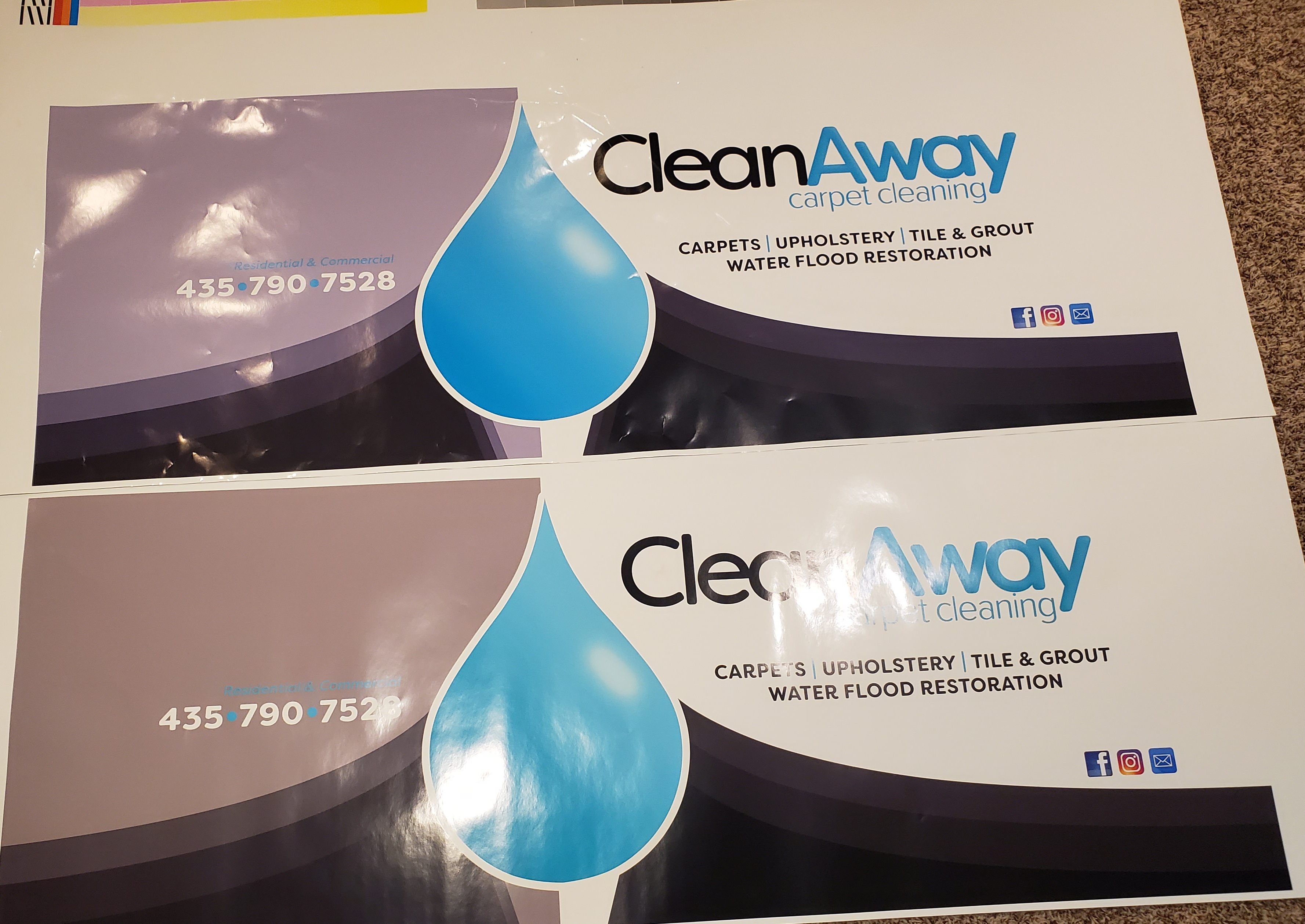

I have a latex 560 and most colors have been printing fine until I was printing some samples for a job on arlon SLX. I color calibrated it and the greys from the calibration look great. I cleaned the printhead did a test plot print and everything seems fine there. I printed again win the same results then I changed the printer to use s different media profile but still printed on the SLX and it came out grey, only other issue is the blues changed to more green then. I have a picture for comparison. Can anyone tell me what I am not seeing in the RIP or somewhere else in the profile, thank you for any input.

Be careful under what light condition you check the colors. Color ist reflected light, and depending on the light source colors can have deviations, and with grey they are very remarkable. ICC-Color profiling is based on a standard light source near to regular daylight. Color deviations because of light can be there too depending on the media.

What RIP are you using? Did you do a color calibration on the printer before profiling?
Onyx 18. Not sure on the color calibration before. Probably not? Been using the machine for 8 months now an have had nothing but good luck with my greys until now. Even used this same roll with good luck. It just had me do a color calibrate since it was out of date and I like to do one before big jobs anyways to make sure if I have to do work in the future for the client colors come out the same.

You must not have read my post quite right. When I used the SLX profile it was printing purple. So just for the hell of it I changed to a substance X1 profile and it came out better but changed the blues as expected it would since the media's are different. I did not find any solution on the SLX profile but what I did come up with is I cloned my Avery 1105 profile and did a color calibration on the SLX material and then it printed perfect. I think something in my original SLX profile got jacked up somewhere along the way. I am glad I got it to work but still frustrated I didnt find the culprit of my original problem in case it happens again.
