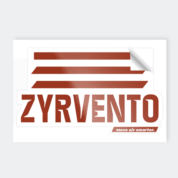

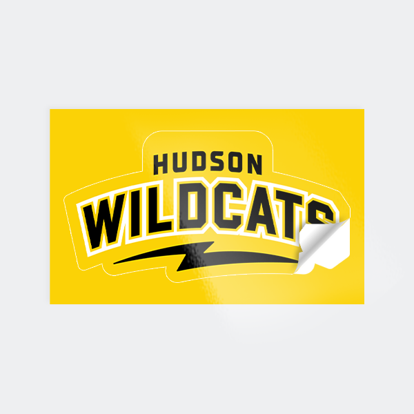

We sell a ton of easy peel borders and kiss cut stickers for this reason.
Adding a small white area around the sticker allows for additional promotion. A second sticker, a barcode, a hang tag/hole, a coupon for another product. All this can be achieved without a second production step.
