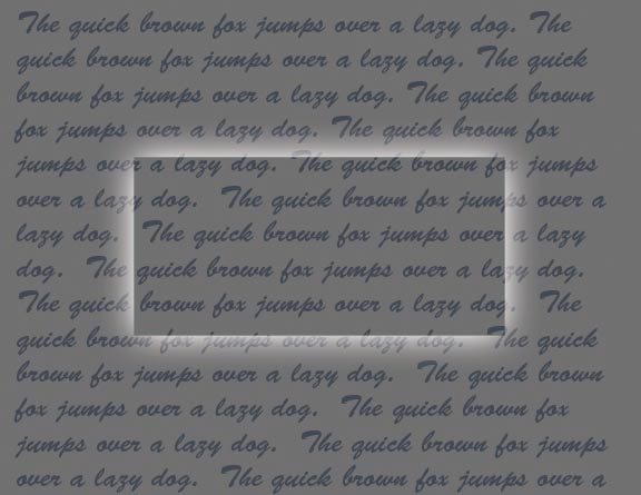

Are you trying to get an effect kind of like this?
~Chris

It's real easy, create whatever shape you want on a separate layer, add the layer style outer glow. Other folks have already told you how to do that so I want repeat it. Here's the trick to make it transparent go the layers palette (not the layer menu) change the fill from 100% to 0%. The halo effect will remain but the shape will become transparent.

I'll try my best. This is just for Photoshop, this isn't the only way to do this but I'll try to make it as easy to follow as possible.
1. Create a new layer and create whatever shape that you want to have the halo effect. Use whatever color you want to create the shape. It want make any difference since the final shape will be transparent.
2. Go to the menu bar and select layer / layer style / outer glow.
3. You should have the outer glow dialog box in front of you at this point. This might take a little trial and error to get the desired amount of glow and color that you want.
If you are looking at the outer glow dialog box, below the word noise you should see a yellow square, click it, this will let you change the halo color from yellow to white (or whatever color you want), click ok once you select your color.
Depending on the effect that your after, you'll have adjust the size and spread of the halo by using the sliders.
You might also have to change the blend mode from screen to multiply. Again it'll take a little trial and error to get the desired effect.
4. Click ok once you have your halo the way you want it.
5. Go to layer palette, (it's usually located on the far right of the screen near the bottom) and change the fill from 100% to 0 %.
