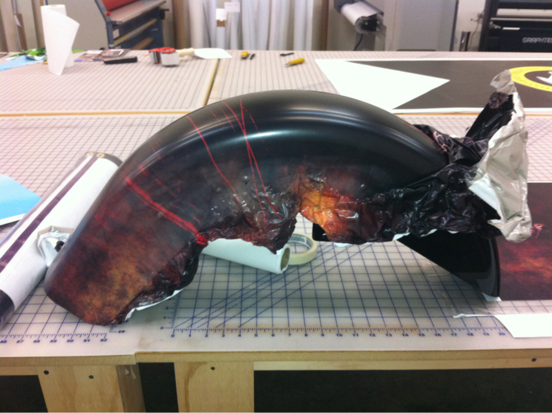

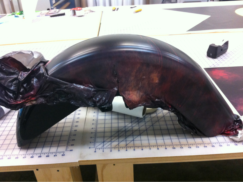

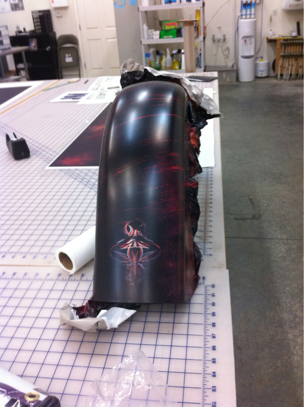

Any suggestions for making this go any easier? This is the last crazy piece of the wrap and it didn't go to well the first time, as you can see. Using IJ180c-v3 and 8520 lam.

Make a rigid mount to get the fender up off the table. For difficult stuff I make sure i have plenty of excess for "handles". Get a couple helpers. 2 hold the material while the other uses two guns to heat. Should go on one shot.

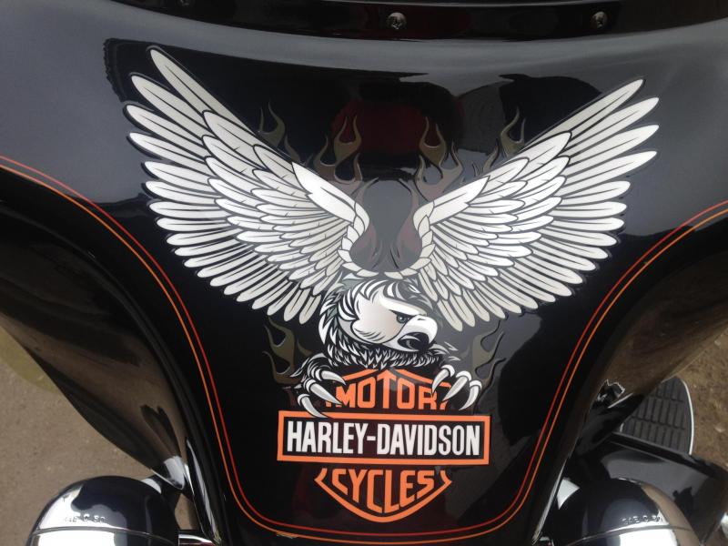

If it helps, in the 2nd picture, you see that image of what I can only describe as a swirly tattoo design? There is a similar one on the opposite side of the fender. Everything else is just rust and texture that doesn't have to go anywhere in particular.

Wrap it without the swirl things. Then put the swirl things on top of the wrap. Yes it will create an edge, but that can be very cool too if cleared over. Gives it a embossed look.

Did one for a friend once- you need a much bigger peice of vinyl than the fender- looks like yours is too close in size. Then lots of heat pull gently...also make stand of some sort- the moving was the hardest to deal with... Got a scrap to practice ffirst?

We have done a few in the shop that turned out fairly well ... the way we did them was build a stand for it that raises it off the table and stops it from moving at all ... make sure you add a bunch of extra material (remove the swirls and add them post install) ... then heat and stretch as much as possible to start, then use lots of patience going down the sides ... takes a bit of time but looks nice and clean once finished.

I did a Harley about 6yr ago. The key for me was to heat and per-strech the graphic front to back BEFORE applying to the fender (backer off). It allowed for a lot of shrinking of the sides with heat. It took 4 people though...
