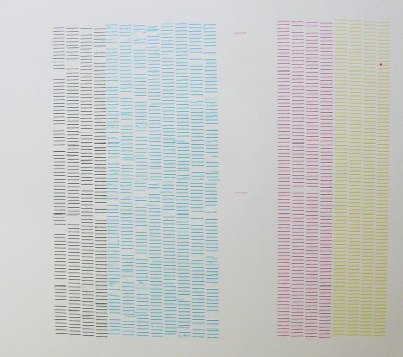

Have problem with CYAN on my VP-540
dgpartsmall
out of alignment
Change the wiper, captop and clean the printhead,flushing the ink via the maintenance option.
If the captop did not be replaced for long time, it will effect the printing quality, many customer found their captop is saturated with ink.
GTSTech_1
You could try replacing the captop and dampers, but looking at the overspray on the print, I would say be prepared for a head replacement.
