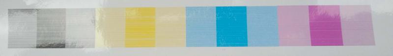

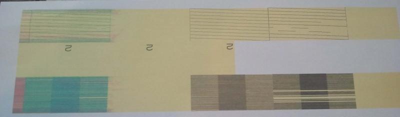

Hi. I maked replace a news headprint DX4 on my RH II 64. But when I try to test noozecheck, 1A-Black and 4A-Yellow noprint. I finded a crash fuse for this heads. By replacing a new fuse, is proccess is still there. I try 5 fuses and problem is always with Me. Trying to replace head cables, control all connects on head and on CR-board, its by must to OK. Please help Me, Thank. (I used a 2A-fast fuse for headfuse).

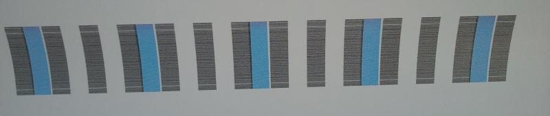

transistors C4131 was replaced, but is me bad luck, only work again head 1A (black), fuse 4A (Yellow) not blow now, when I test noozles, but still fill all noozles yellow over all colors. Now I print only CMYK with 2 head (4 canals). I have a problem with position black against CYAN (3A), I don't know where to adjust it, I think is software to alignment this position, not hardware alignment. Please with help. Thank you. test noozles.jpg IMG_20140823_095439.jpg

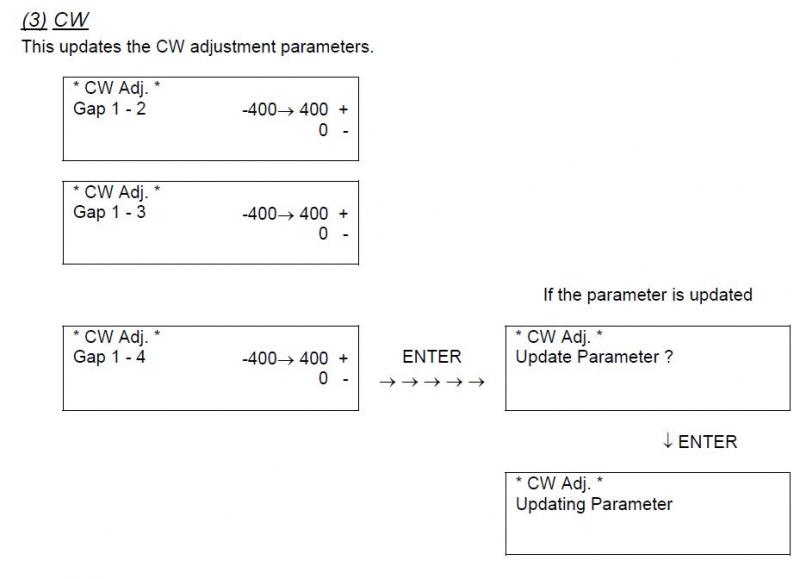

Now is good with CW adjusment in servis mode. My happy.
