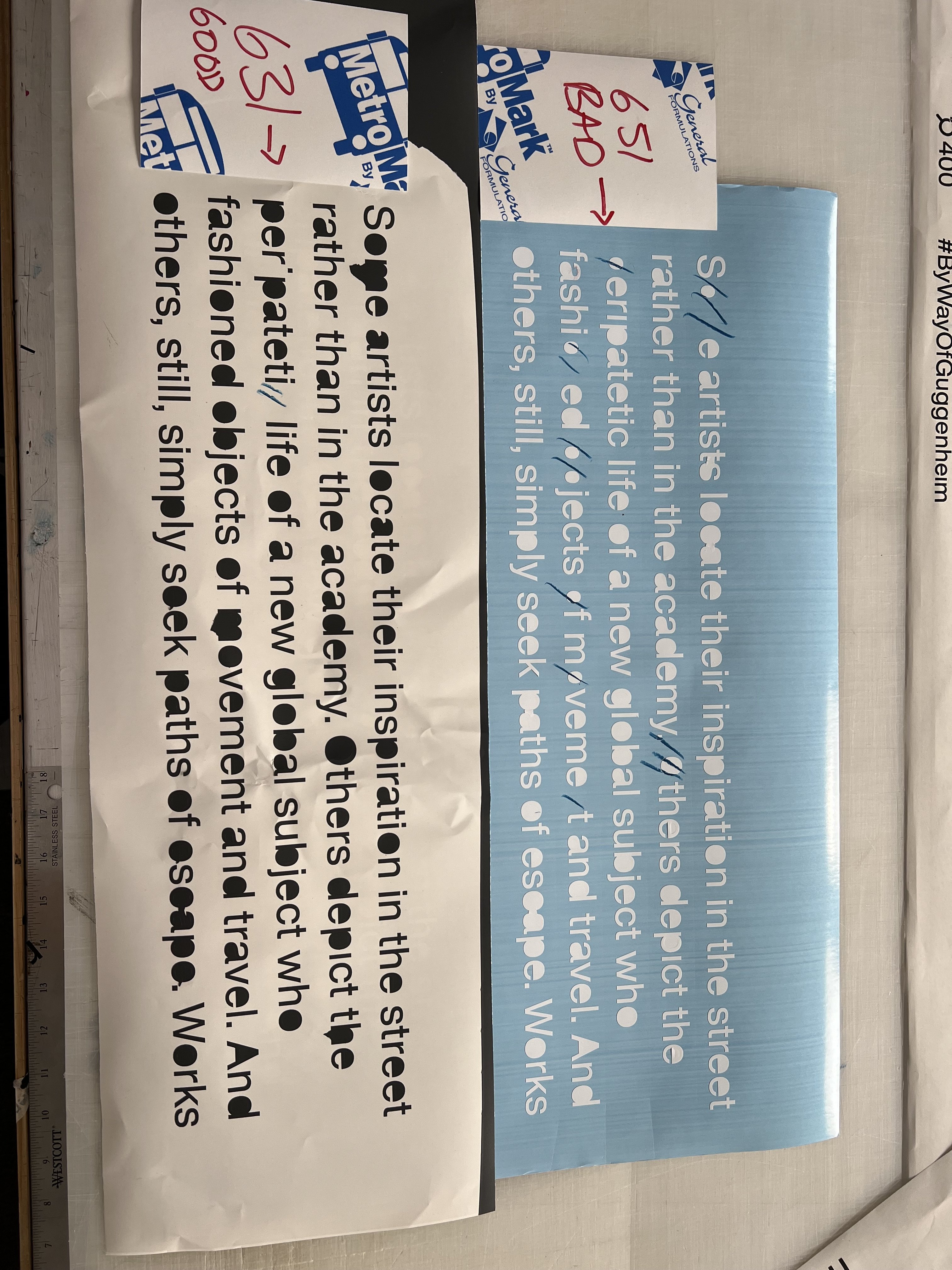

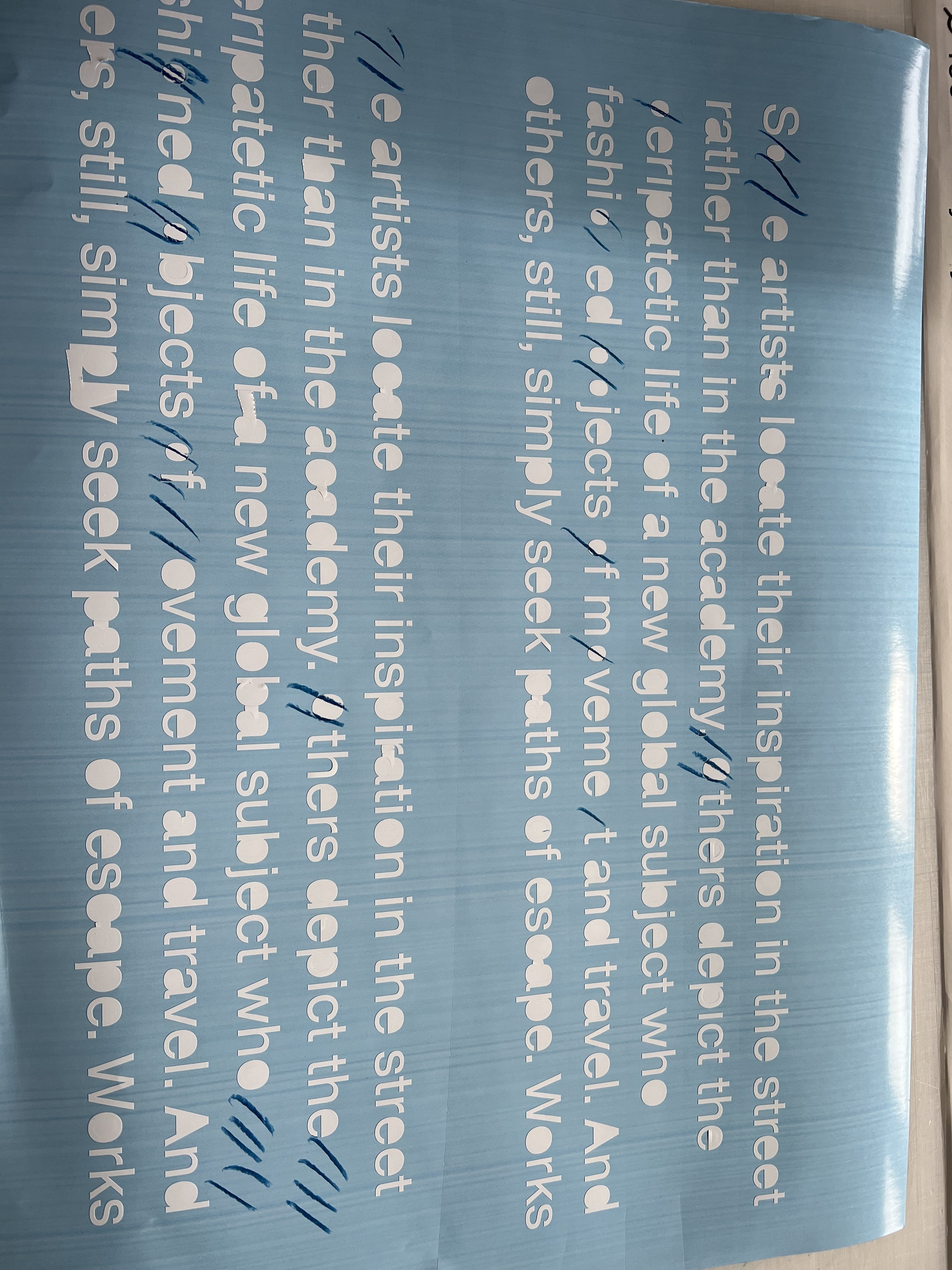

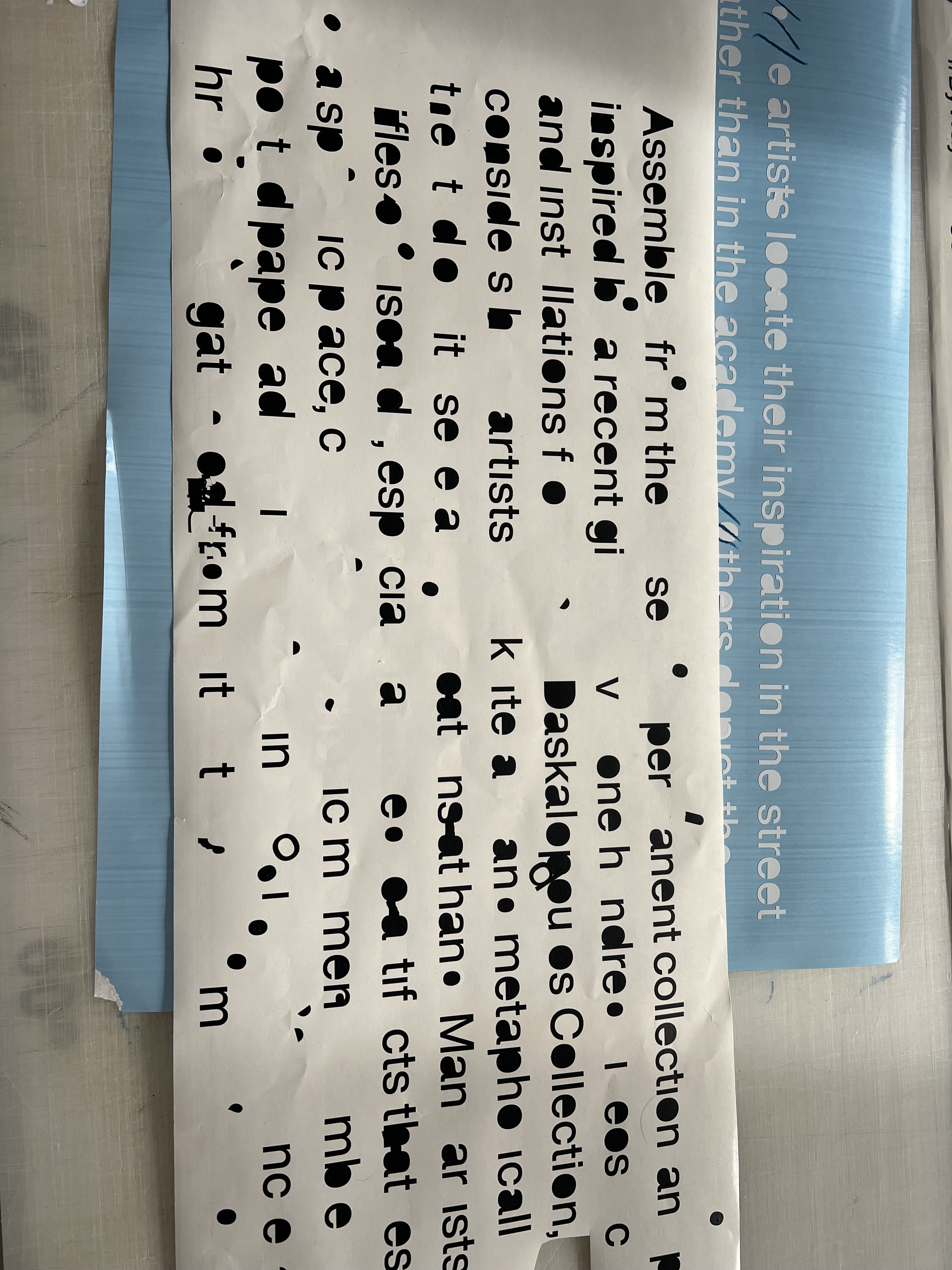

Out of the blue, both my plotters have been cutting inconsistently. I cut a lot of text panels for museums and galleries. 1/2" -3/4" text that usually weeds with a few I dots missing and a couple letters. Recently across 2 plotters, I loose about 25% of my letters. sometimes 75%. The colors it has been like this are mainly Oracal 651 matte black and white. Has anyone come across this problem with Oracal? It just does not seem right that I am loosing so many letters across 2 plotters and multiple rolls of material. I have swapped out the holders, the cut strip and the knife, turned on tangential mode and messed with the offset, slowed the speed. Graphtec says its material.
