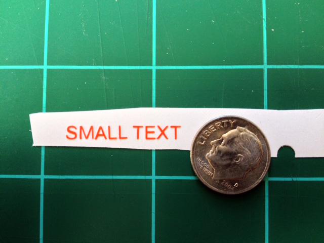

Finlay got it working. Turns out the cutter wouldn't accept a 9pin to 25pin serial conversion. I got it running on a parallel connection. It's a nice cutter: quiet, fast, and so far pretty accurate. But I haven't tried to see how it tracks on anything over 6' yet. And, thank you J Hill. It was the generic HPGL driver.
