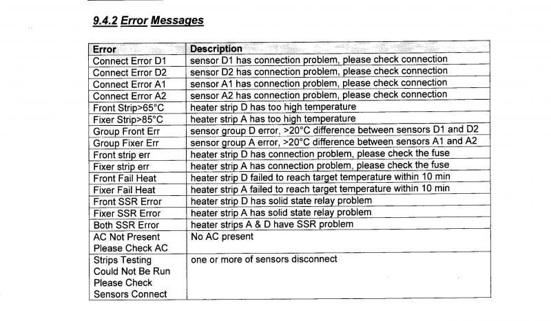

i'm not a tech but let me ask ; do you have a service manual? did you check the fuses? is there an error readout on the panel, or are heaters just not working?
AUTO-FX
possible error messages
Extreme
Thats awesome .. thanks for the printout but its not sending any errors. the heater in the front is working fine the fixer(rear) heater is not heating at all. the readout don't show any errors the only thing i noticed was that when the front heater gets to temp the fixer heater starts flashing. so the "R" is flashing in the heater readout. The service manuel im getting i had the one for another machine so im waiting on the last service tech to send me a pdf of it. He said he would but havent seen it nor can i reach him..lol part for the course lol.. anyways i have checked the fuse under the table for the front heater in the circuit board. this is the only one i have found. I pulled all the panels off the machine and followed all the wires front the heaters to the ends and made sure everything was connected and didnt see anything out of the ordinary. Im lost at this point so anything you can do would be a great help beyond here.
