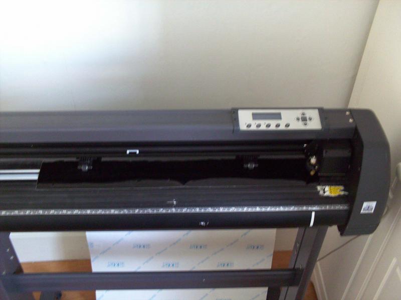

Hi guys, thanks for all of your suggestions. I'm still having no luck! I have installed Flexisign 8.5 and re-installed the cutter. Ihave tried all of the available Comm ports. On most of them the job fails immedaitely. On one of the Virtual USB ports it says it's cutting, but stays at 0%. I have tried turning off the cutter, but to no avail. I am now wondering if this cutter is indeed a Master Cutter (as it was advertised). There are few identifying marks on it apart from a serial number (2084) and a type number (MT871). I will try to attach a photo. Could anybody help me to identify the exacy make and model of this cutter, then I might be able to get the right driver?
Thanks in advance

Doesn't look like my Master cutter. The control panel is different and my cutter is very pale gray...almost white. Mine is model XY-300P
