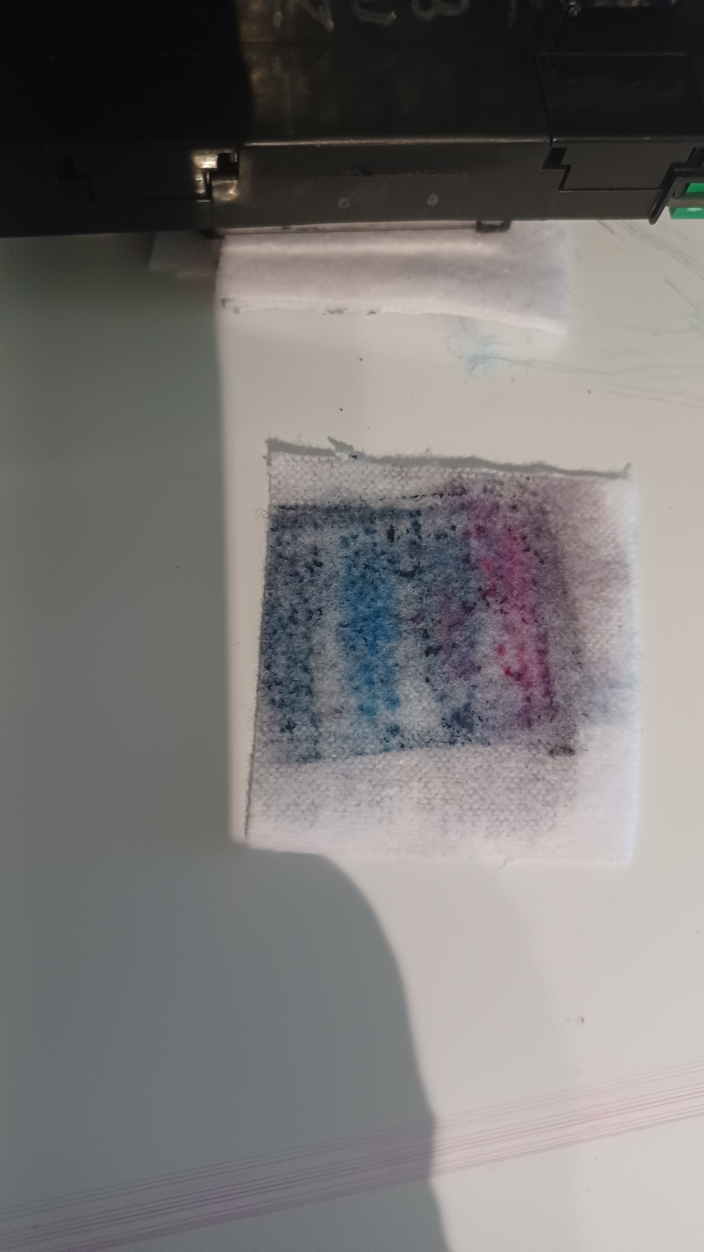

OK I'm back guys. I had ink going through my printer up until about a week ago. Then didnt print for about 2 days. The maintenance station lines indicated ink going through the waste inks when I did a cleaning. But I decided to print a small picture and nothing came out. I have changed the maintenance station, changed the f2 fuse, I did a reset with taking out the chip on mother board, made sure all connections to new maintenance is good. Took out head and made sure seated right. And that the cables are good. And still getting ink through when cleaning but nothing printing. When I had head out I put on patch and looks like head should not be clogged.
Does anyone have any ideas? I'm going crazy again with this machine.
