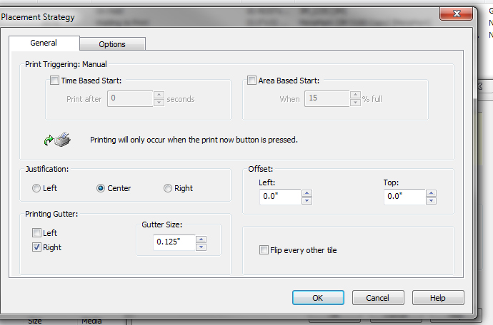

So a full reinstall seems to have fixed the issues, however, I'm now missing a whole bunch of my settings. Most I can just reload/rebuild myself, but one that I am missing and cannot seem to find is the ability to shift things both left and right.
Ideas?

Here's a snip from our 12.2 install:
We never used v11, and didn't do anything special to get these menus in 12.2. Just came part of the standard install on the 3 machines I had a look at in the office this morning.
