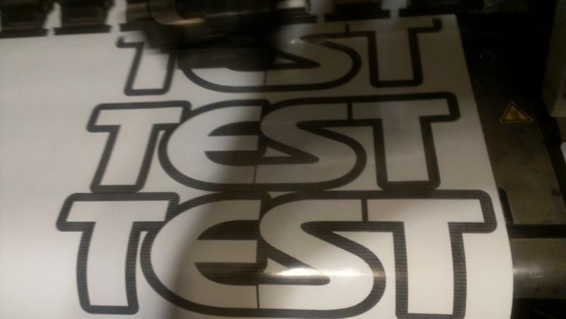

I have a Mutoh Outdoor Jr. with flexi 8.6 and windows 7. It was printing fine a few weeks ago and now for some reason all it will print is black. I have done a nozzle chk and it prints color so I know its not the head fuse. Can someone please help me out I am running out of ideas on what could be causing it. Below I will show a picture of the test print that should be red, outlined in black, shadowed in blue.

If the test print of the machine show all colors and the rip does not print correct colors check in Flexi there is an option to print in BW only...............check if the option is not checked.

coulg be your printer is stuck in black mode. happened to me a while back. on your control panel if the 3 quality/speed lights are all lit, you are in black only mode. will still do a nozzle check with all colors, but prints a file black

But normally the rip overrules the hardware setting for that and resolution except for paper feed setting.

On the panel on the machine left bottom switch says mono/color.

Open a file and select print and rip.
In the rip and print screen go to the Advanced tab.
In the option Color mode check that CYMK is choosen.
Let us know the result.
