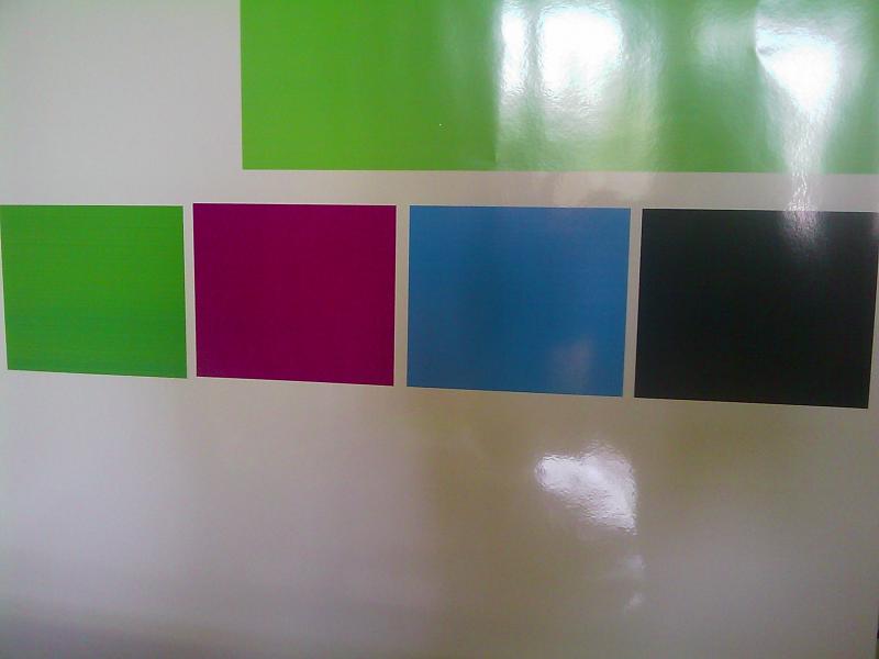

okay i added a full ink cartridge and did a powerful clean, and still the same so I need to keep doing the powerful clean until it gets better? also should I run the cleaning cartridges through the system? heres is a picture of the test print

randya
pull the cart out and check the puncture mark to see what color ink is in the cartridge.
If it is a factory cartridge it will have a stamp on one end ( i.e. a circle with a Y for yellow).
There should be no normal reason to run cleaning carts,
Connect a syringe to the small drain line that goes in the waste bottle for the color head and pull ink through.
Check the lines to see how much contaimination you have, just take a flash light and look under the hood.

I finally got it working right again, would like to say thanks to all of you for your help. Thanks RandyA I ran the powerful clean about 4 times and it started printing normal again thanks for your help.
