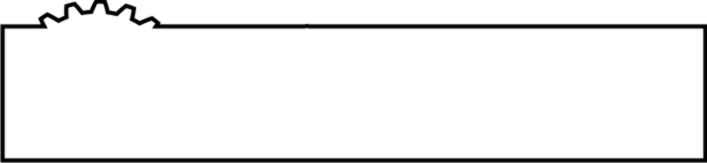

I need to put a sign out that needs to have a contour cut.
The sign will slide into an existing slot in a shopping center (broken) light box.
The size is 6ft long by 18" the sign will be a rectangle for the most part but one corner will be about 25" it would be the top part of a contour cut gear.
My question is should I use sintra or aluminum....sintra is fine in this application what I am looking for is what is the easiest to contour cut...and how (razor?)
Pic attached of what final shape would look like.
Thanks!

Won't the constraints of the lip around the can stop you from sliding this thing in all the way ??
Also, unless the sign is totally disconnected, I don't think I'd be messing around with a box where the can doesn't fit the face perfectly.
dfeicke
I couldn't open your thumbnail, but from the looks of it, it's all straight cuts, right? If you're careful, sintra should cut OK. Just keep in mind that it will crack.
If there's any tricky little curves, you may have to use some finesse in the cutting.
This oddball shaped cabinet hopefully has moldings that come off, so you can just set the face in. Sounds like fun!
Pat Whatley
Sintra is going to crack.
Aluminum is easy enough to cut with a jigsaw, dibond is easier.
I'm with Gino, I don't get how you're planning on sliding it into the box but I figure you've got a plan for that. One thing you may want to consider is just doing a rectangular sign and then attaching a fully cut out gear to it, maybe on standoffs. It won't take very much longer and it's an easy way to add a little dimension (and money) to the job.

The sign goes in the top slot and is the highest part of the sign so we made something to serve as stability for the top channel.
Pat, I was thinking about that too...a separate piece, would you go with something other than aluminum for separate piece?.
Is dibond very expensive?

I agree with Dibond, around here it's cheaper than 0.063" aluminum and it's a lot easier to cut. It's more than PVC though, but it'll last a lot longer too. If you're planning on sliding this into a typical retainer you won't be able to use anything thicker than 3mm PVC, which I would not trust outside. If you can't find Dibond brand, there are others like Max Metal and Poly Metal. They're all basically the same, we use Poly Metal.

If cost is an issue you could use "e-panel" is a few bucks less than dibond.
e-panel
Alcan Composites USA has recently introduced a new ACM product designed for flat sheet applications. With many of the same great features as Alcan's Dibond® product, the e-panel? can be saw cut, routed or punched. It is suitable for direct digital or screen print, and is ideal for mounted graphics. Masked both sides, the e-panel? has .008" aluminum polyester painted facers with a solid black polyethylene core.
Applications Include: Suited for flat sheet applications only, suitable to mount graphics and for both digital and screen printing. can be cut, routed or punched.

The panel is going to go into a lighted sign cabinet. I also get the impression the lights no longer work. As a tenant, I'd be bitching to the landlord on that. But that is another issue.
I know how to do this on a billboard. But in a cabinet where the one corner has to be 7" taller than the rest of the panel? Seems to me that there has to be some jury-rigging and my concern (for the other tenants and the landlord who owns the sign) is how to keep the cabinet weatherproof? Eventually, that sign is going to be re-lit and keeping water and scree out should be a primary issue.
Seems to me, that the only proper way to do this is to use the proper plastic for the 72" x 18" panel and then fabricate the additional extended piece from the same material (get a scrap or two from your supplier) and 'glue' it on at the proper place. The 'glue' in this instance should probably be UHB tape which should not be a worry as no illumination will be passing through since it is outside of the cabinet.
You can easily fabricate that additional piece from scrap via a hand-held saber saw. Just put a few layers of transfer or masking tape in the cut area and on both sides of the plastic before cutting.
Pat Whatley
Since the sign cabinet has channels that the panel slides into I'd really do just a rectangular panel and slide it in. Then cut your gear from dibond and attach it to the rectangular panel with VHB tape & rivets. It'll make it an easy job out of the project.
Dibond runs about $60 for a 4'x8' sheet. It's about $15 more than aluminum but MUCH, MUCH easier to work with due to the rigidity. If you cut the diameter of the gear down to 24" you can get the whole job done with half a sheet.
'G' has the direction you wanna go. In fact, I think some others have mentioned the same route earlier.

Well thanks everyone for the help.
I am going to use an external piece and just keep it in the slot like some of you said.
