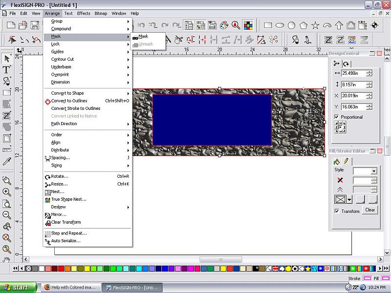

gvgraphics
Import your camo BMP into flexi along with your file. Set the camo to the back and then lay your graphic on top where you want it. Then click arrange on the top of your scree and then mask. This will fill your graphic with the camo fill.
