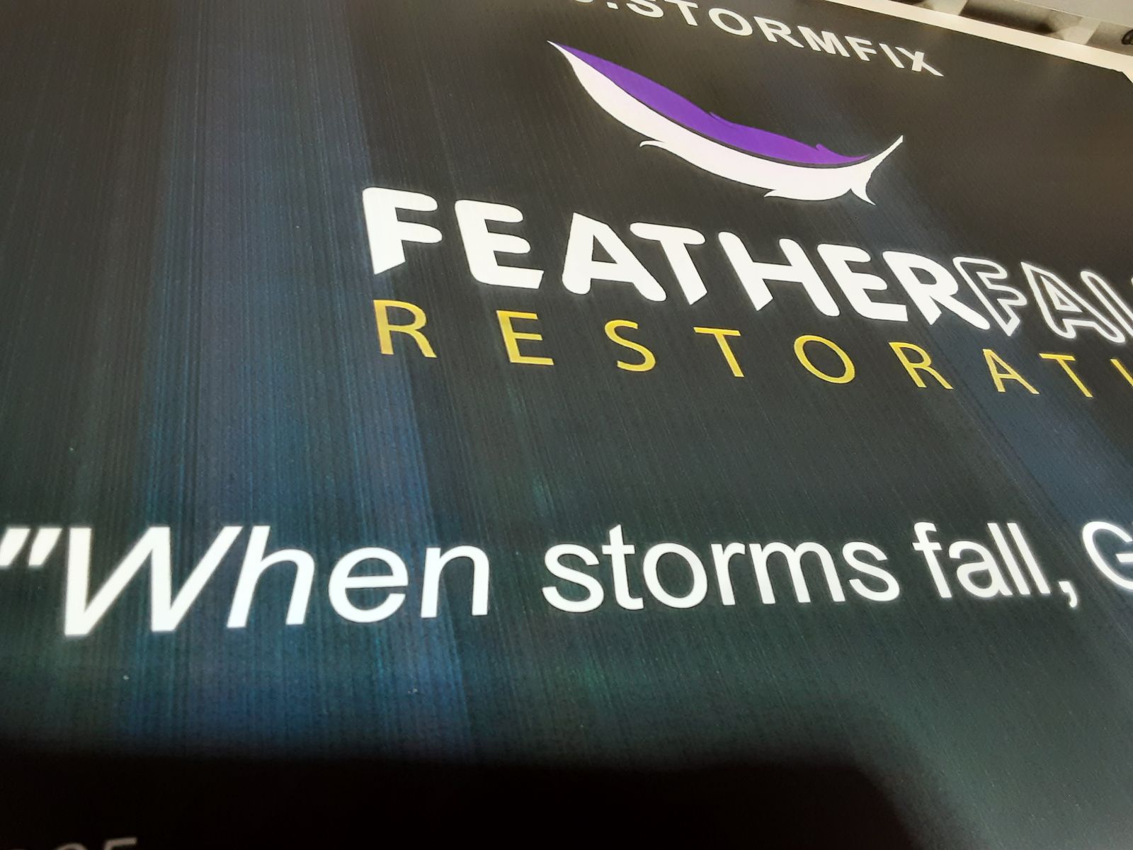

I work with some HP FB750, and lately I have had problems in one of them with the black color, now every time I print the black color some blue lines appear,
this only happens when it is printed in express mode, in indoor mode looks good, at first I thought it would be solved by doing air purges in performance, it works but after a few minutes the lines reappear, then I try to do the maintenance of clean the printhead and the same thing works for a moment and the next it doesn't, and doing a jet mapping doesn't work in express mode, which is what I'm looking for,
I leave a photo and any help is welcome. dd501067-0a3f-4ccc-845c-3e4a52d9dd2e.jpg

Several reasons could be. Meniscus settings, the air filter could be clogged on the black line, or the printhead's rubber gaskets are too old and can't hold the system hermetical.

When we had an FB500 we would never print solid colored background in Express mode as you would get banding.
