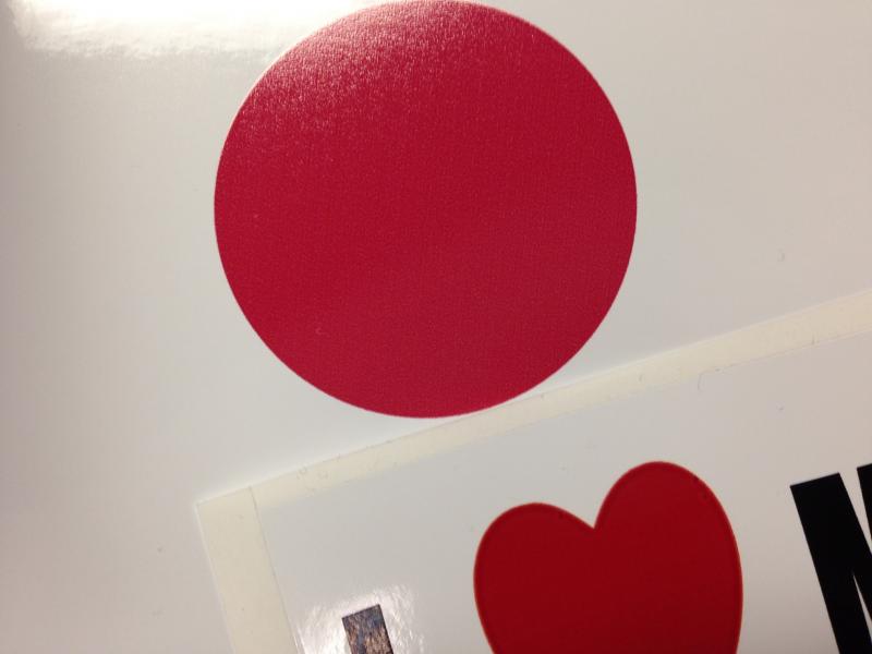

If i print in flexi it prints the correct color red.
When i export and print with versa its way off, i've tried several different rgb #s and still off.
What is you RGB # for your brightest red?

SpazSigns
still needing help.
the bottom red is in flexi. That is the color I need.
top is in versa.
any help appreciated.

Auburnpeanut
In the photo you provided the two reds look very similar. If they are not in real life, try taking a picture at a different angle for us to see.
