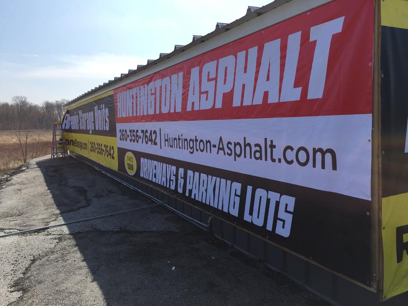

We just did this 7' X 60' and then one on the other side that's 7' X 25' and it's just standard 13oz banner. We just frame it out with wood, then fasten all the grommets to it. We've done them up to 20' X 20' in 13oz standard banner and not had any issues. They normally fade before they have any issues with tearing.
