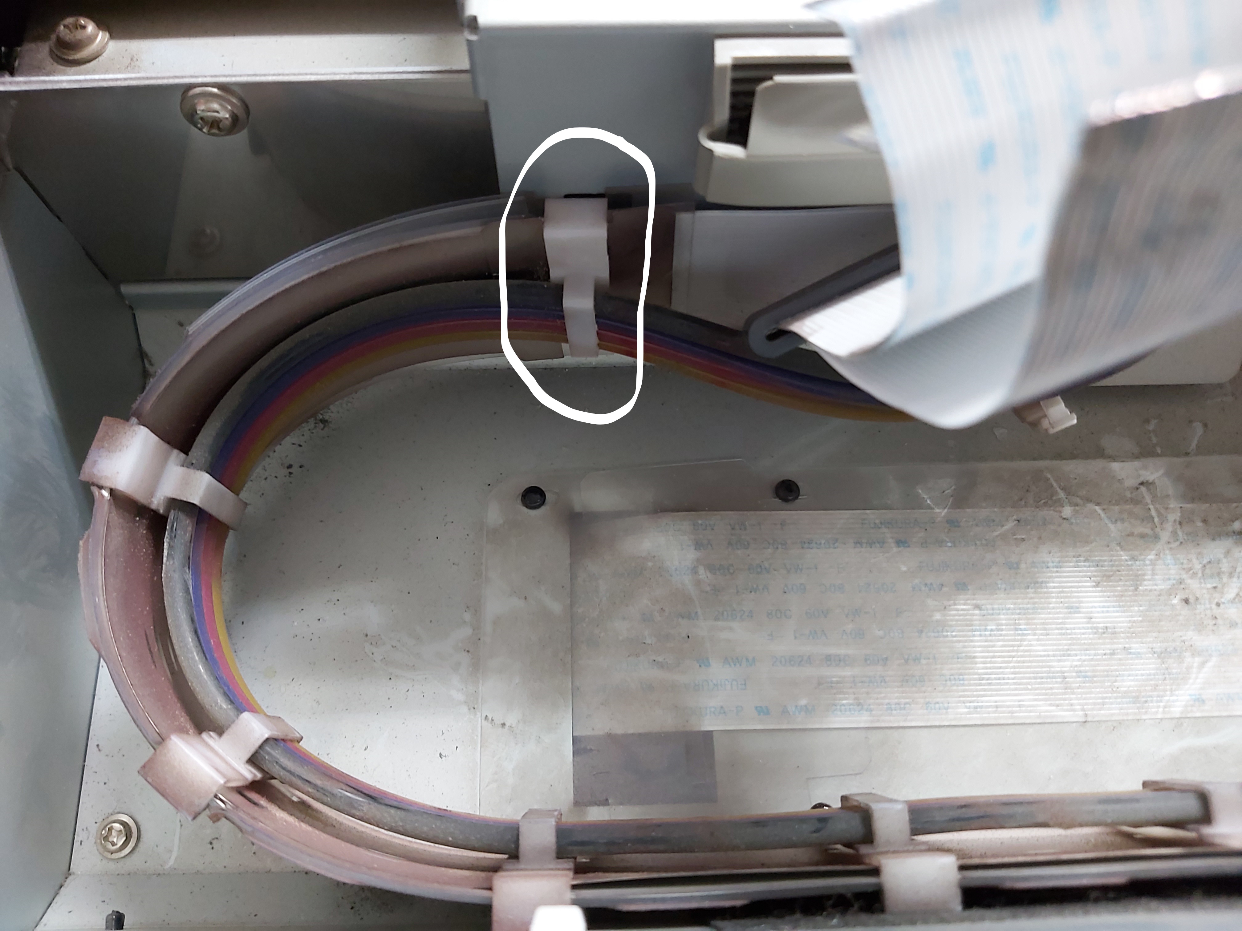

We struggling with the holder cable where the pipes and cables are not sitting up firmly and is causing the head carriage to jam or makes a lousy clicking noise. The technician has tried to ensure that everything is clipped in nicely but somehow the cables seem to sag which is causing it to get stuck
Any ideas?

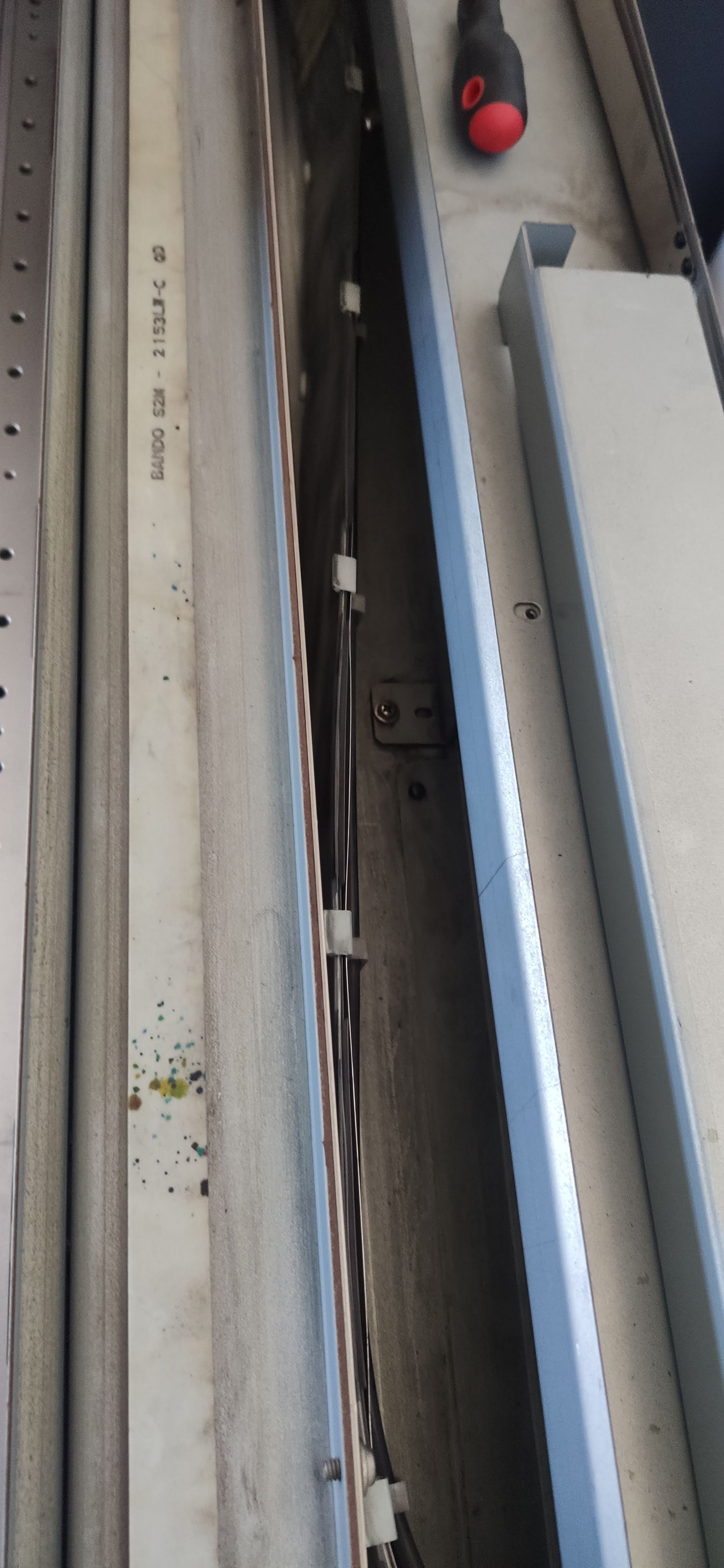

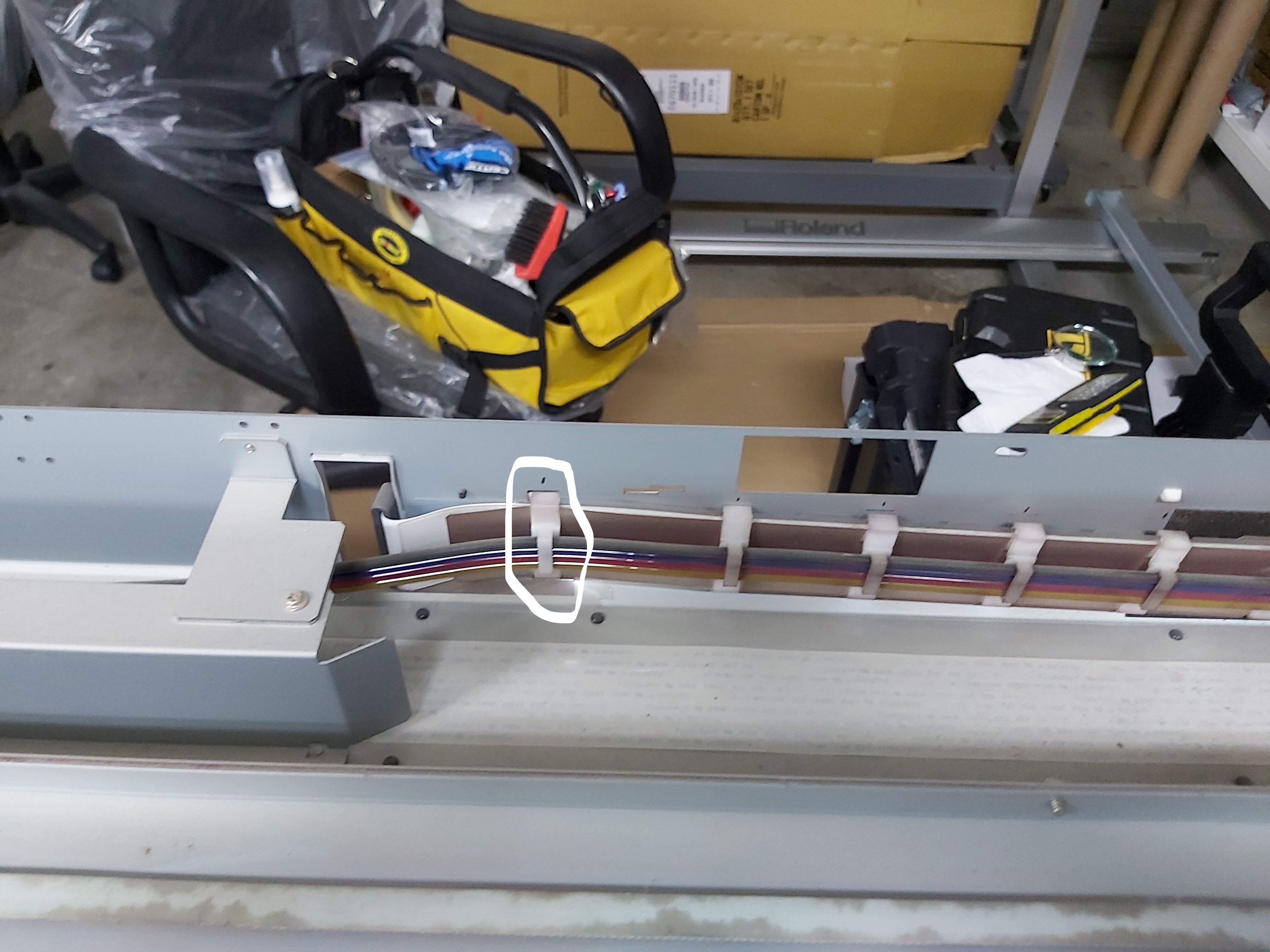

Ok! The first plastic clip holder and middle (with cable going out) will need to be lock down top and bottom on the metal slot...see pix

Thanks man.. I noticed that wasn't locked down but then eventually realized a piece of the plastic holders was broken and caused the cables to sag. I eventually removed all three holders and bought clear plastic thats used as a cover on the snapper frames and cut it out according to the shape of the holder and its working fine now.
The reasons I went that route is because i cannot find the original one in stock
