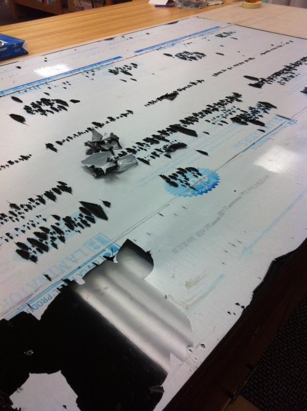

How can I remove this? Weathered Alumalite Wrap
TheSnowman
I sold this guy a sign probably a year or two ago, and I left the material covering on the back of it. Now he wants something on the back, and I quoted the job w/o looking at the back of the sign. Is there anyway I can do something other than sit here picking at this thing for a day to get this off of here? Some chemical?

Been there done that. Thought I was protecting the back for future use, NOT. The UV degrades that thin plastic. In the end we just used a new blank. It seemed cheaper than time it would take to remove it.
TheSnowman
Yea, lesson learned. I've got 20 mins in it and MAYBE have 1/3 of it done. I'm ripping that stuff off from now on. A little "weathered" look would be fine in comparison to this.
TheSnowman
I can tell you this...Alcohol and Adhesive Remover does NOTHING. And I tried the laminate thing, no success there either.
TheSnowman
Here's what ya do. You call the customer and tell them that they can pay you for 3-4 hours of removal, or that since you already quoted it, you'll lose a few bucks on a sheet of PVC and sell them that for a few bucks more than what you quoted the job for. He took the bait, and I lost less money than just having no other alternative.
LEARN FROM MY MISTAKE! ALWAYS REMOVE BOTH SIDES!

Someone once told me to use spray adhesive on the backing and on the back of backing paper from another job. then let it sit for about an hour. Never tried it. I was too scared that it would be worse to get off if I did that.

In a perfect world, yes, but then the whole thing towards the middle turned into 1/2" pieces that were baked on...the other 2/3 is RIDICULES.

Why not just razorblade it off and cover it with a sheet of black 751 to cover scratches? I suppose it's too late now lol
TheSnowman
I'd rather give away a cheap sheet of PVC than go to all that bother. If it was a print, then yes, but it's cut vinyl.

We had the same issue not too long ago. Sign had been on a building a long ime, and they wanted us to use the back instead of buying new aluminum. After cussing it for an hour and scratching it all up, i decided it was just easier to replace it. Now when people say they want me to use the back of a substrate, my quotes are contingent on being able to use it, and they know in advance.

Wonder if a MBX would take it off.

I have an MBX, I wondered about that. I figured it'd do the trick, but then I'd have the mess that that thing leaves behind, and still not be much ahead, and have another $35 eraser to buy.
