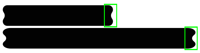

I have a very simple graphic I need to adjust the various lengths of from about 12-48"
My issue is when I stretch it in Corel or Flexi the end radius changes.
I know this has to be ignorantly simple, but I'm still learning both programs.
I think I can hack it, but would rather know how to do it correctly.
Anyone care to throw me a bone??

In Corel if you have the image converted to curves, grab your node edit tool, clik and drag the tool over the nodes on the end of the graphic. The nodes should change to a solid color, use your arrow key and move them out until you reach the desired length.

in CorelDRAW! convert to curves, select all nodes on one side, hold down ctrl to lock axis and drag!

the easy way I do it is to drag a copy out to wherever the other end should be & then weld the 2

In Flexi:
Make your desired square to the height you want say 4".
Then go to your Design Central and uncheck Proportional..
Design Central:
Type in your desired length...
If you have multiple sizes you can use the "step and repeat" function...

In Corel..after you do the stretch... delete the original and make a new box. Simple..effective. Fast.
