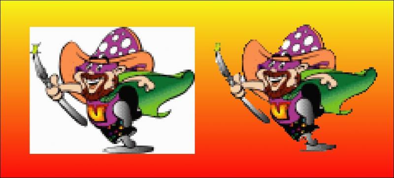

your avatar was a .gif, which I opened in PS and it showed up in the index color mode. I changed to rgb & got the familiar "background' name in my layers pallette, then following my instructions above, I saved as a .gif (with transparency box checked) I made a gradient box in illustrator, & placed the original .gif I swiped from you post, followed by the one i just saved:
