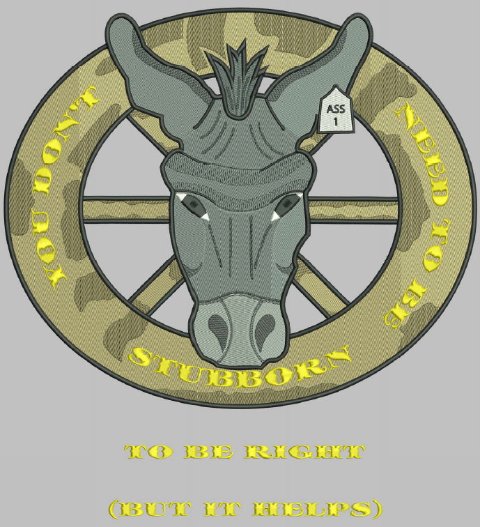

Of course, nothing is really going to beat a simulated preview done with an embroidery program (although they do have digitizing plugins for Ai (although the one that I'm thinking about goes for 3k for the full license)). The chenille one looks the most finished, but it doesn't look like embroidery, it looks like chenille.
