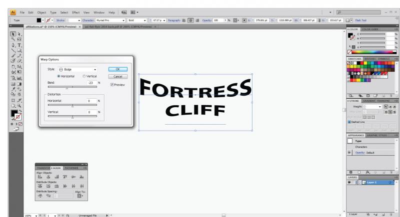

I've tried the warp presets but none of them will give me this type of warp. I tried drawing the shape and distorting with the top object and that turned into something unrecognizable. I tried "warp with mesh" and I could get the shape I wanted but it distorted the letters (see attached). Any other suggestions? Thanks!

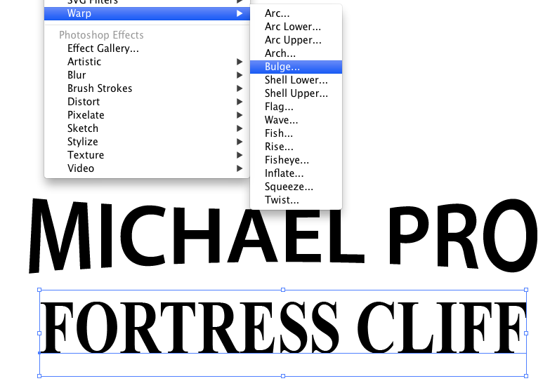

I'm not 100% on this but would this work?
Effect>Stylize>Warp>Bulge Then make it a negative bulge.

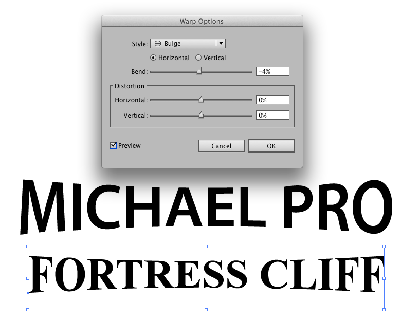

MikePro
EDITED: +1'd Firesprint's suggestion. Negative bulge

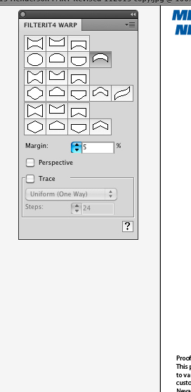

mpn
Plug-In like this makes quick work out of warps.
