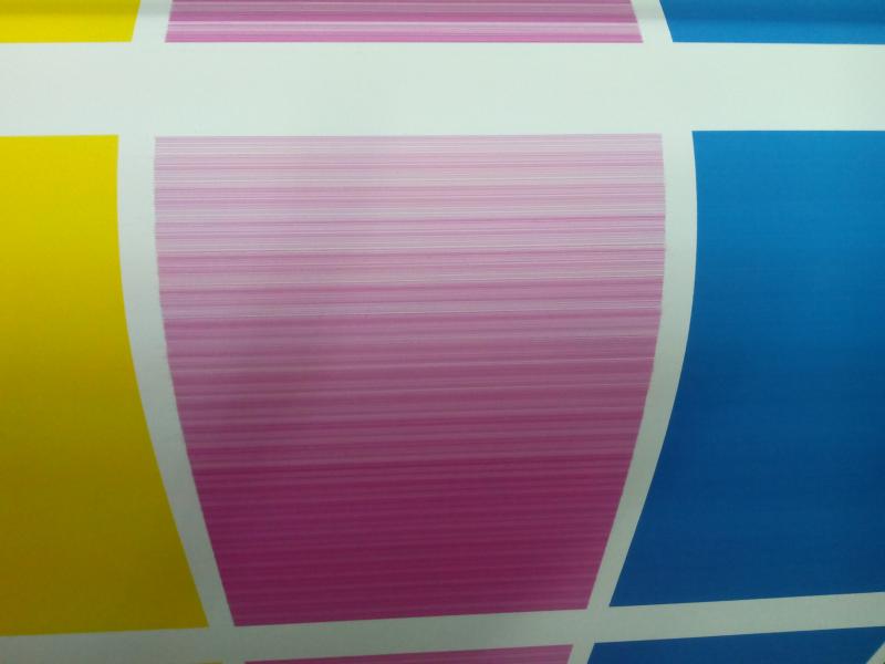

I have a problem in my hp 10000s. This machine start to make banding at amgenta color. Since that i have checked all ink circuit, pipes, sub tanks, primes, capings, selenoids, and all is ok. At last i send the printhead to perform a recovery at the printhead doctor machine, and the print head is ok.
I change the flat cables that connect to main pca and change the conections at main carriage!,
All the assembly parts were changed... i dont know what to do to solv the problem... anyone got more ideas?
