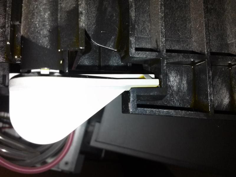

I got a "Missing Cartridge" ERROR yesterday.

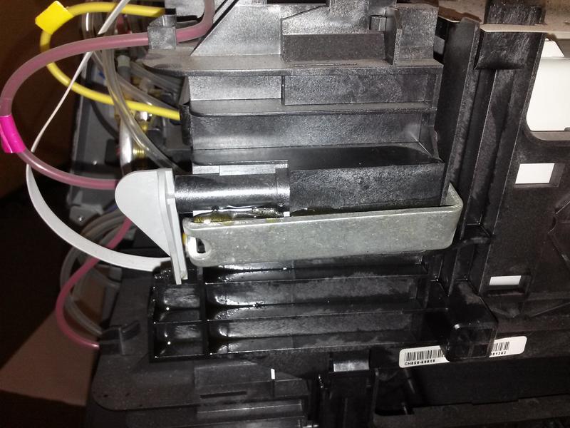

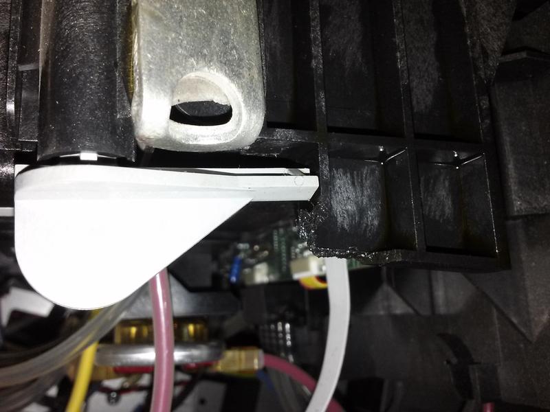

Once I took the cover off I discovered a broken piece of plastic, further investigation and it was the tab that held the top rack of carts in place.
I figured if i tried to use superglue it would just break again so I fashioned up a steel C type bracket to hold it in place.
