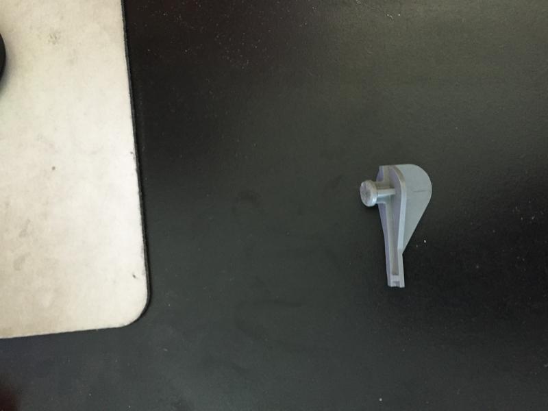

Can't believe HP does not sell the grap clips that hold the tubing on th back of the ink cartridges. One of my VIPs broke now I have to buy the whole ink transfer tubing unit for one broken clip. Anyone replace their tubing unit have and have a couple clips?

These are so damn cheap, my HP just broke another 2. WTF????? Was not printing or changing ink. Walked by and heard them snap

These are the clips that keep snapping

Mate, im telling ya...dont get new clips or a new IDS. Cable tie the racks in place and it will never happen again.
