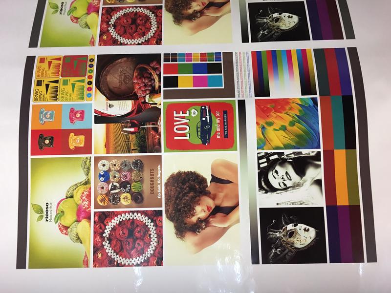

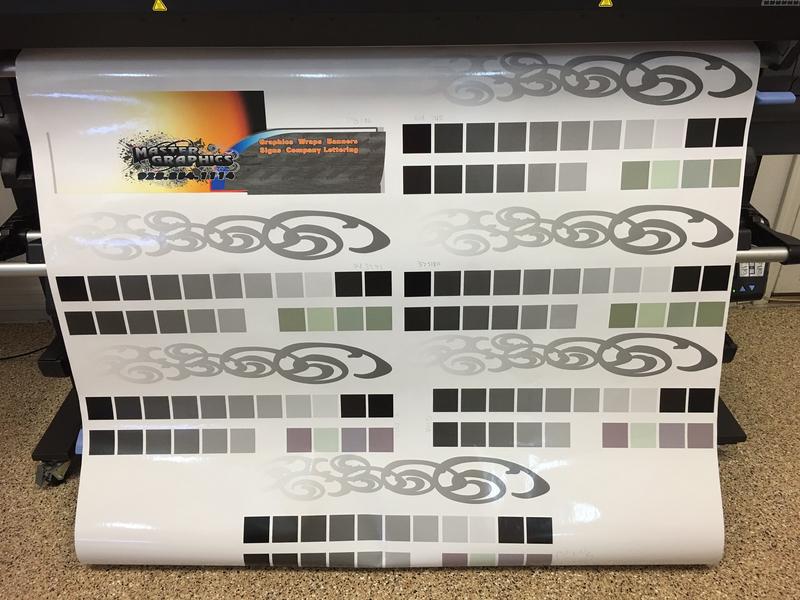

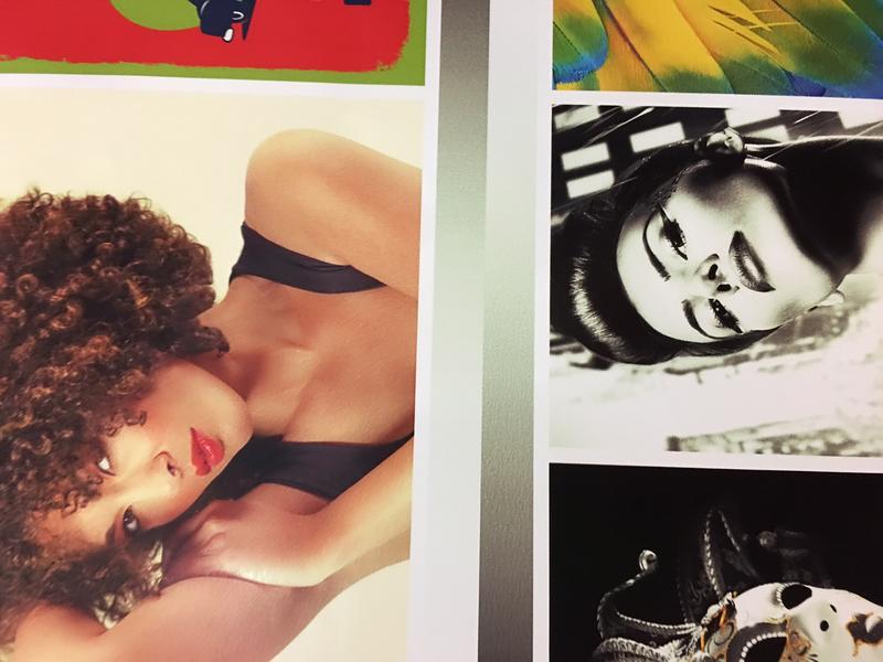

I am wondering if anyone has had an issue with their latex printer printing gray's with a green hue? The machine is just over a year old and we have had no other problems. It was recommended to replace the printheads after 1000ml of use, we did that and it is still not right. HP support has been here and they seem to just throw parts at it. Has anyone seen this happen or have any idea what to do next. Thank you

Yes they are my own profiles. I have used them since day 1. At first HP had me make new profiles, and it didn't fix them. The last 2 pics are HP's internal pics, not from my profiles. Guess i'm new at color management, not sure how to adjust that. The program we use is Flexi-Sign Pro

On closer look at your samples it does appear that there could be a problem with the light magenta. What does it print like if you make a media preset with only using CMYK and then create a new profile for that setting?

Not yet. Since it's green from the internal print HP knows it's a problem on their end and not from my software. One day it just started printing that way, but of course it was on the 60' for my own truck. we didn't realize it until we started laying it all out.
