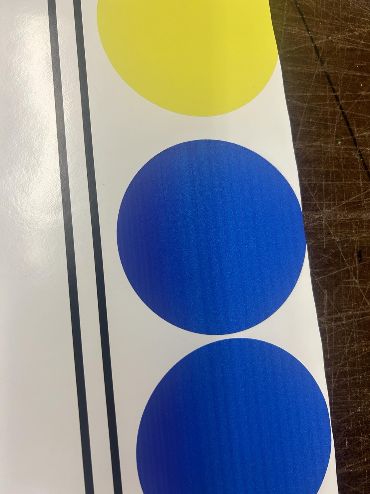

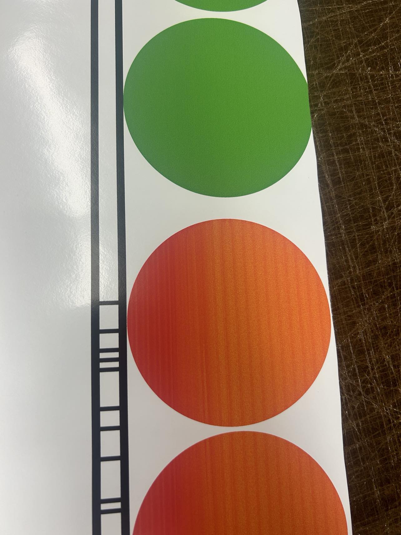

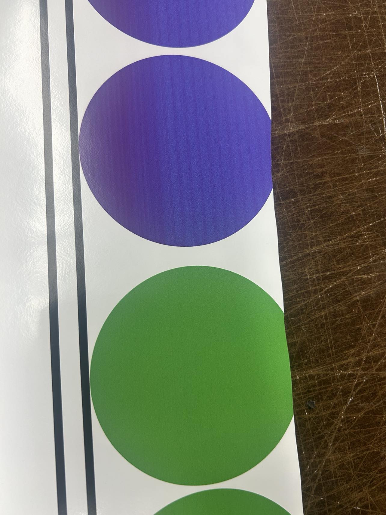

I'm not sure what's going on. It appears to be something with magenta. I'm trying to print some 3" circles today for a job and looks like this...
HP 315, Generic Self Adhesive 10pass - this what I typically use and haven't had issues like this. Any ideas?
421098487_3529192130627759_9164585788276801657_n.jpg 421377385_3661228040781400_4980362905235075793_n.jpg 421036185_917127209982369_240683974211318410_n.jpg
I'm stumped because everything looks OK. I ran a printhead alignment and a color optimization.

You replace the printhead.
Actually I recommend to replace both at the same time.
MonsterBabyBLN
What does the printhead plot look like? It is most likely only one head that down. And at the beginning it always compensates that with more strikes.

I changed both the magenta/yellow heads and it prints beautifully!
I talked to Geneva today and she said there's a screen that shows which printheads are misfiring. She didn't recall how to get to it as she was busy but if anyone else knows, I would be interested!
Before changing any heads you need to check run the FORCE DROPLET DETECTION, this tells you how many heads are clogged.
Once you run it, write down the numbers for each head and then run a cleaning on all heads and run the test again. This will tell you what's really going on with your heads.
To get to the test you need to get into the service menu, the bypass code is 3174
goto setting ->
service menu (enter code 3174) ->
scan axis menu ->
Force Droplet Detection _>
this eliminates changing both heads.
