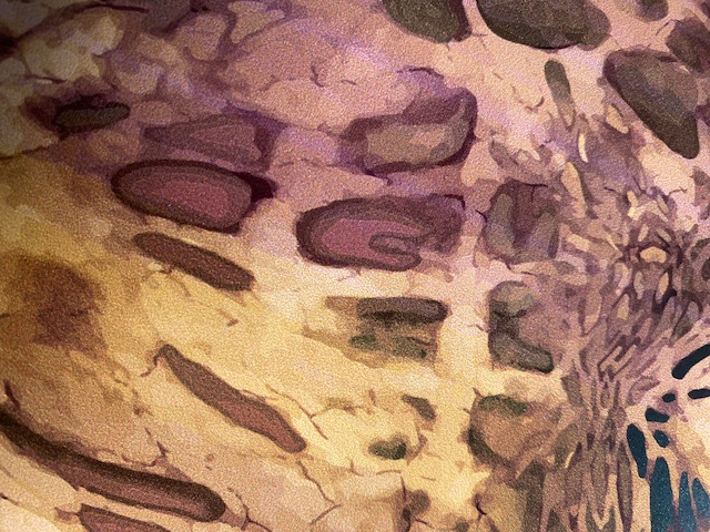

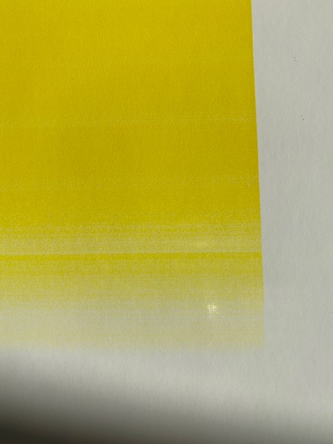

Our 570 stops printing yellow ... or severely reduces yellow output after a few feet of printing. This happened soon after changing the large ink for both yellow and magenta. I can clearly see the banding and greys are purple/lavender.
Replaced both YM printheads even though all tests show fine. No change.
Replaced large ink with new yellow ..... no change.
Replaced optimizer ... no change.
Replaced intermediate yellow cartridge ... no change.
Not sure what to do next? Out of warranty and my tech hasn't been able to give me an answer yet.
