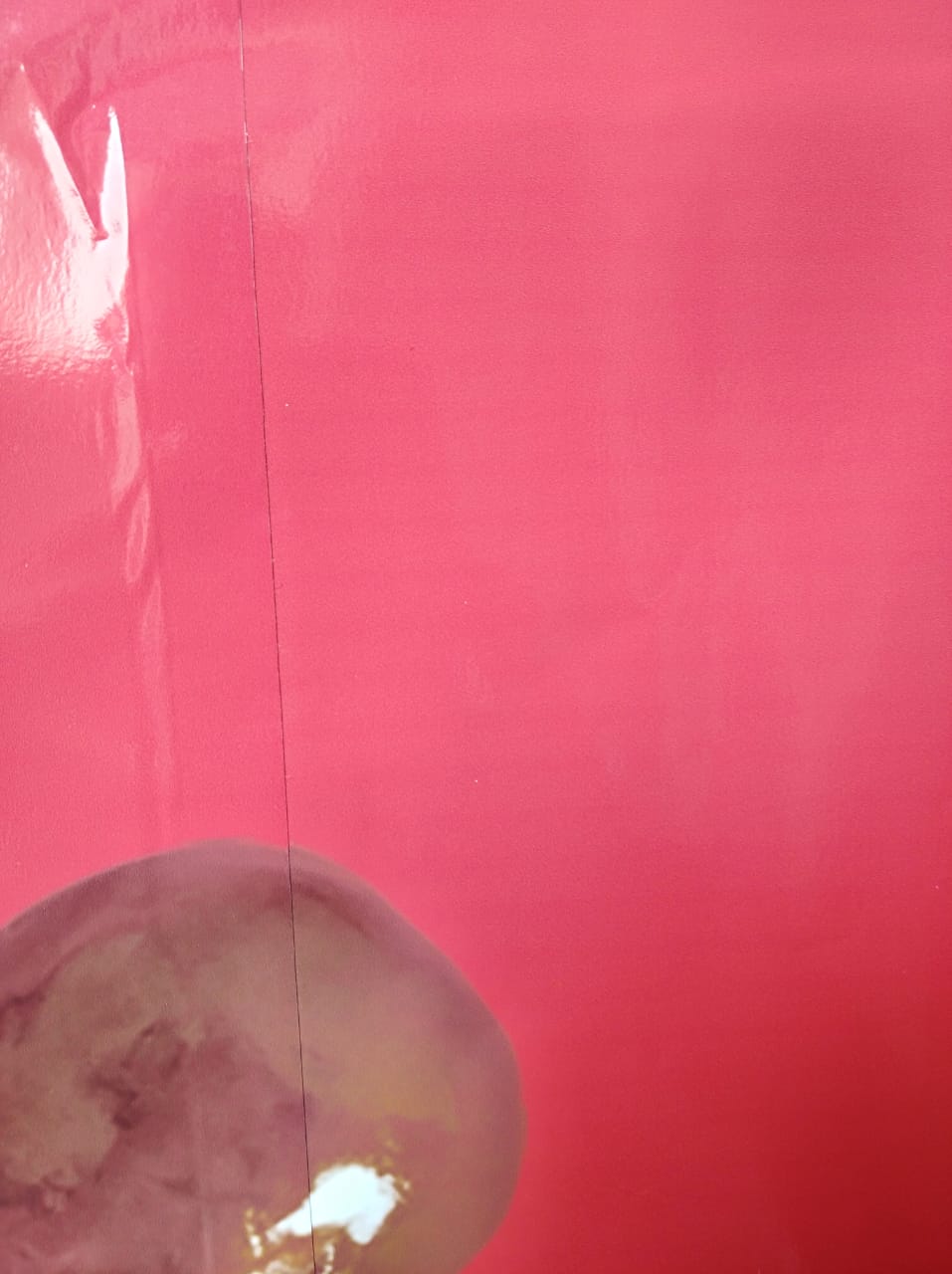

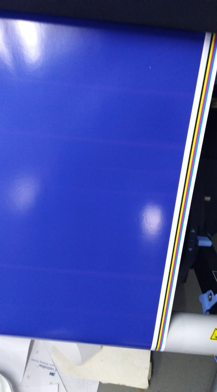

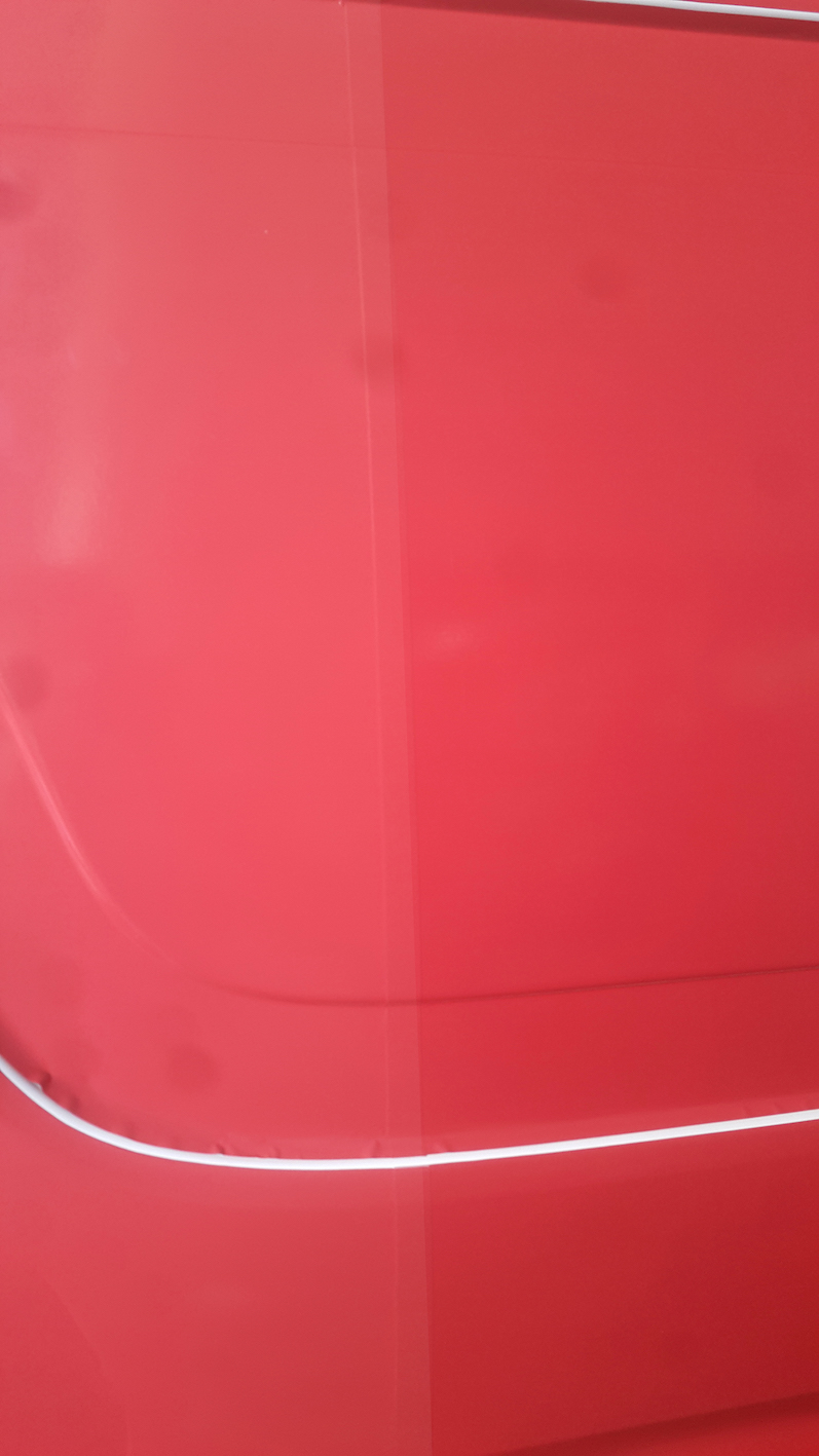

regarding the images below are some images

Good Day
The images show panel to panel mismatch - Correct?
If this is the case a few things might not be correct.
1. Make sure in your RIP you can rotate every other tile.
2. Make sure you complete a colour calibration frequently, even before the front panel displays recommended.
3. On certain colours you may have to change your printing to 12 Pass and possible print CMYK only.
The blue picture is showing ink starvation or head failure;
1. Turn on confidence strips at each side of your image.
2. In the printer profile, setup a print profile to 12 pass and in advanced settings change interpass delay to 300.
3. Check the life of your heads, especially the LM/LC this head depending on the colour can become strained if printing too fast or if it is old.
4. For colour consistent prints, repeatable and consistent, change printheads every 6000ml or when they start to perform badly.
5. Error 98:03 indicates a head has failed to meet the required quality, too many nozzles have failed and printing will be affected.
Hope this helps

Dear Sir,,
Yes color mismatch between panels
the rip auto rotate all the panels
color calibration is made before each printing
i always print on 12 passes cmyk 3M ij 180mc profile
regarding the blue this is the bending im talking about and the heads on this job was all changed before the printing
we change the printheads at 2000 ml
to keep all the hardware new
