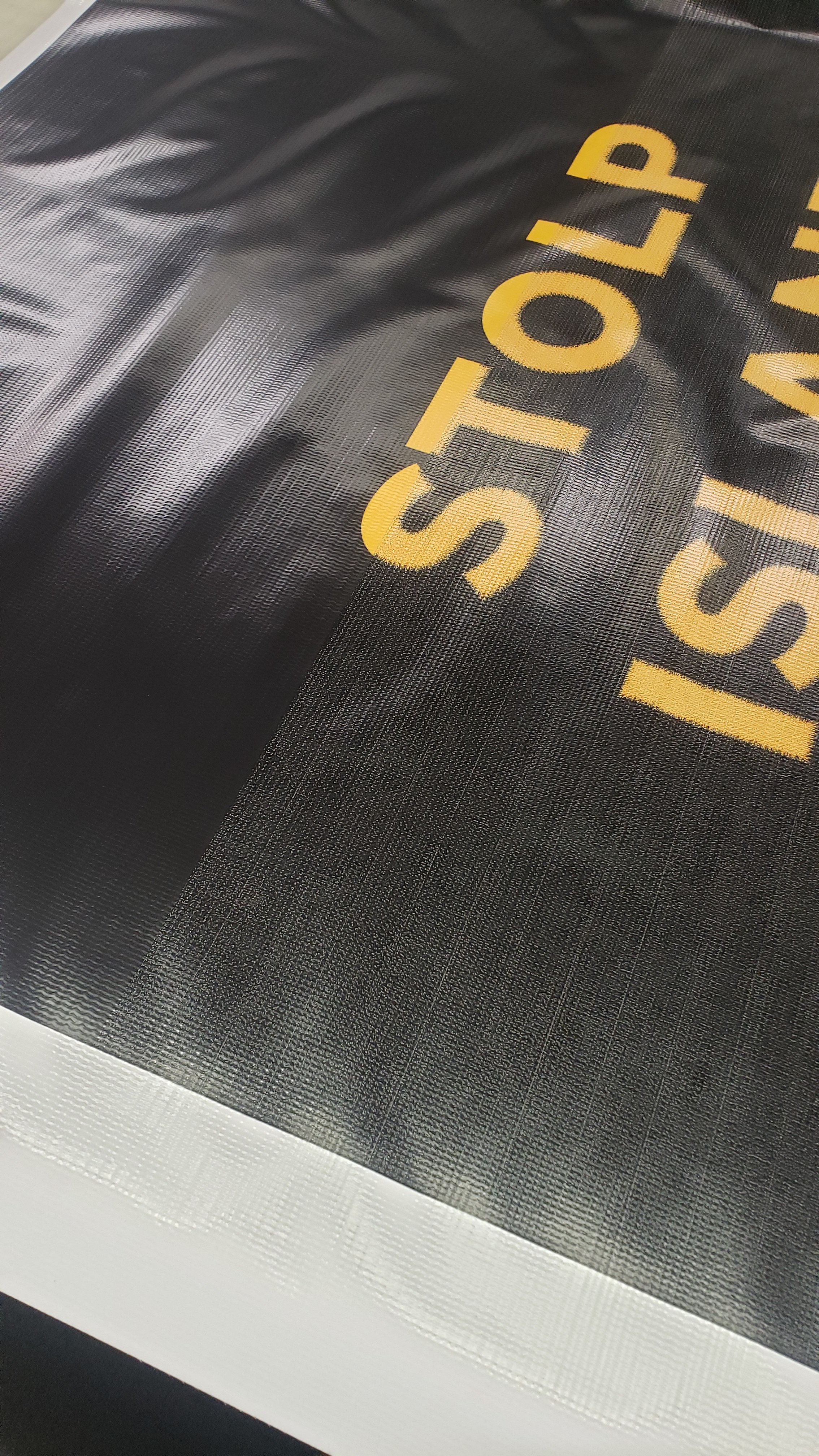

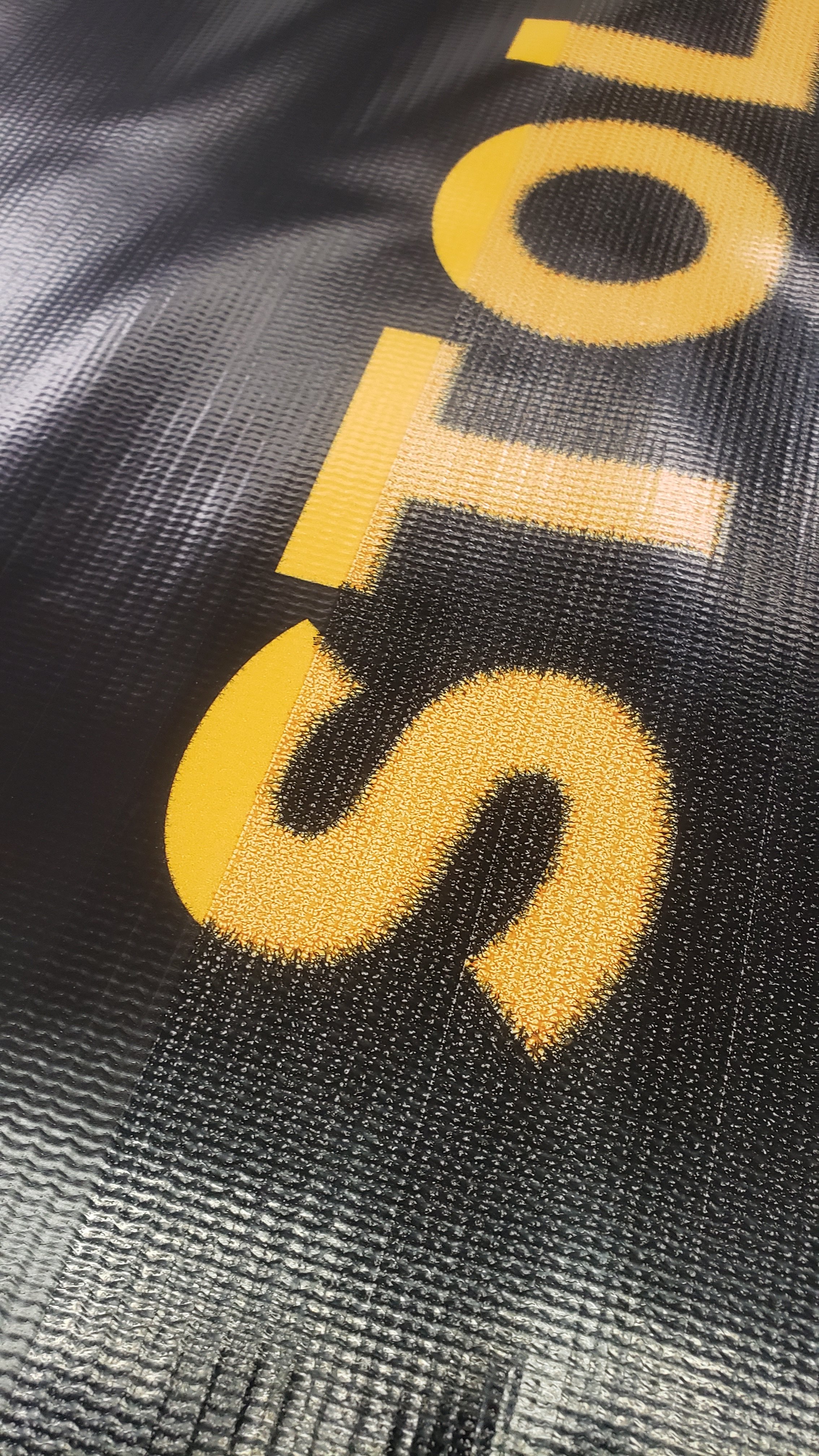

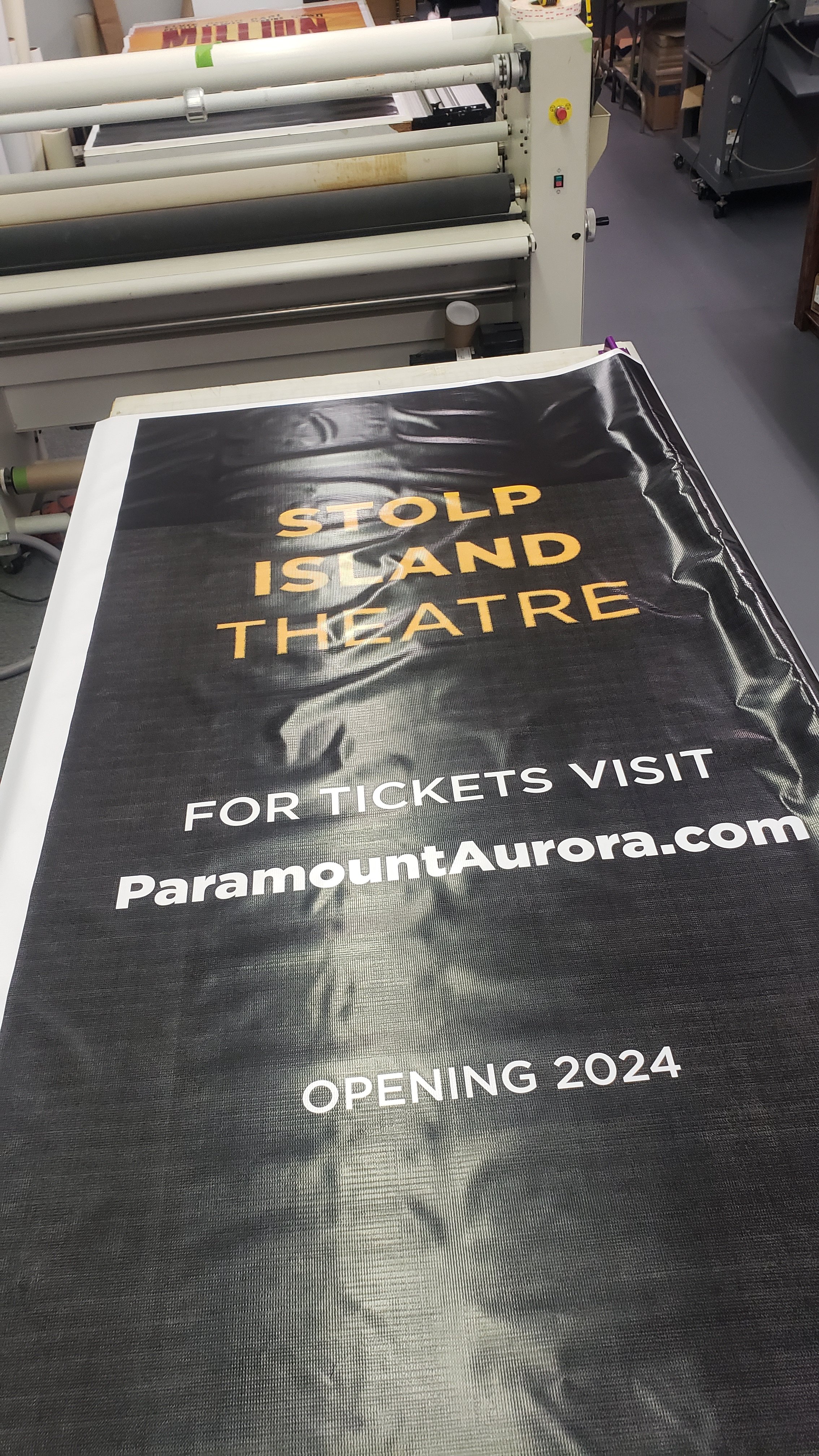

I ran 3 banners 13oz, the first 2 came out fine no issues but the 3rd one as you can see something happened while printing.
I just swapped material and ran other jobs and they are fine.
thanks for any suggestions.

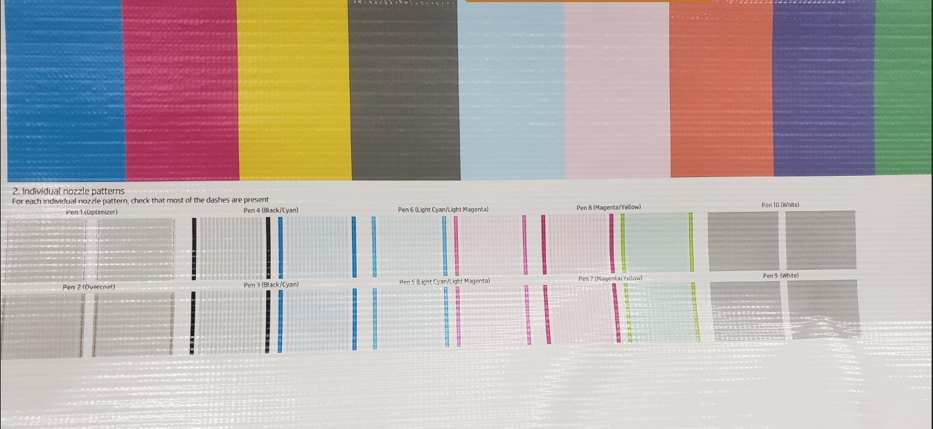

I have had this a few times.... if it was my 700 I would try a head cleaning first just to see if it changes, then if it helped, look at a new plot - then consider putting in a new optimizer print head. (for me the main clue is the plot is the worst on the optimizer, but any of the other prints that need optimizer look bad too - like the bars on the side of the plots of the other print heads....) Remember the optimizer must be maintained in a very controlled pattern, likely more so than the colors as the shower of optimizer helps control the spray of the other inks.
BigNate
so replace it even thou other jobs are coming out fine now?
thanks for the replies!
Our 700w came in with some intermittent connection problems with the printheads - fix was replacing the white ribbon cable that has the contacts to the printheads. But we would get intermittent firing like you are seeing.... it is obvious a printhead is bad, then it just starts working, then in the middle of a full roll print it goes to crap again and you lose the whole image.... I recommend doing a little research into what happened. You may get lucky... but I think an intermittent connection somewhere in-line with your optimizer printhead is the actual problem.
