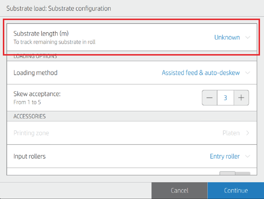

Hello, for those who use the HP, is there a way to have the printer keep track of how much roll is left? we made the serious upgrade from an aqueous Canon to the latex, and we love the prints... however, I am finding I really miss how well the Canon managed the rolls, especially how much media was still loaded.

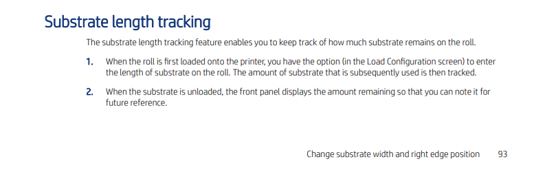

It is for sure in the loading screen. This is from the guide.
When the roll is first loaded onto the printer, you have the option (in the Load Configuration screen) to enter
the length of substrate on the roll. The amount of substrate that is subsequently used is then tracked.
When the substrate is unloaded, the front panel displays the amount remaining so that you can note it for
future reference. (Only with next upcoming firmware update! Now you have to look it up before unloading.)

Thank you for all the advice... the HP tech showed me where the line is... with the 700 it will not automatically keep track. You must set the preference for every roll loaded, and though it is easy to get to, it is 2 folders deep - not something to randomly find.

I don't know where he showed you to do it as you will see the option to give the length every time you load and it's right there, no need to go under any options :help

yes, click on the substrate length, then open the next dialogue box, then open the box that lets you type in the length - have to do for every roll. All previous printers I have used had a virtual switch that was on or off for every roll - as it stands, if an operator blindly follows the prompts to load the length is not monitored. Extra steps have to happen. not a big deal, but makes it less idiot-proof. (generally I do not like idiot-proof things, but having the switch when multiple people can be using the equipment would keep rolls from having length unknown.)
