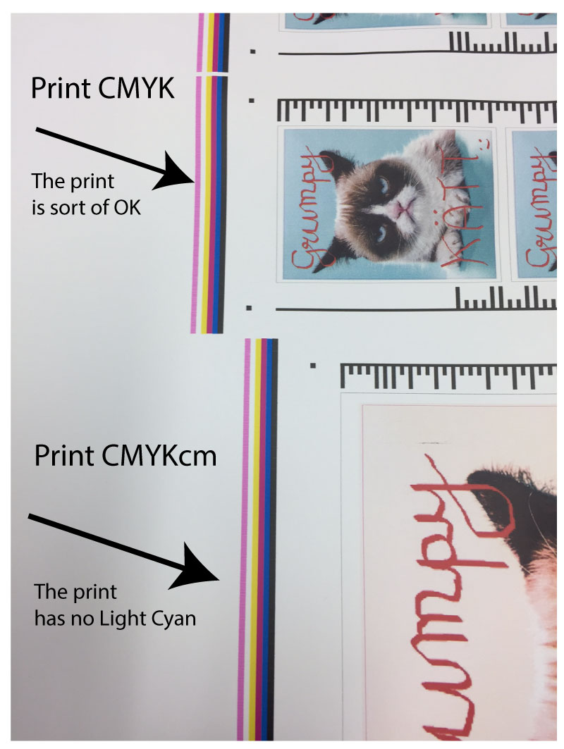

Since a couple of days, our design jet 8000s has stopped printing light cyan.
I use it with Caldera V8.
If I change the setting in Caldera to CMYK, it's print quadri. But on the control stripe the light Cyan is not there at all.
A few days before I replaced the magenta print head. But immediately after that all the heads were printing fine.
Then a couple of days later, the light cyan, just stopped receiving any ink to the head.

I attached a photo example.
Any advice would be greatly appreciated.
