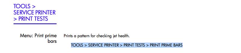

GP_Oz
attachment.php
Better than the nozzle print for sure.
