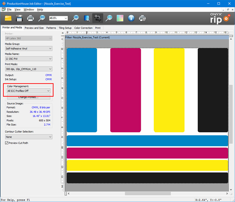

The place to start is to disable color management for a CMYK-based job such as the file that is attached.
It is important that you turn off all color management in the Preflight module (see attached image). The purpose of this test is to isolate whether your issue is Printer based or RIP / color management centric. Disabling Color Management (see highlighted list box) should send the CMYK values straight through to the printer, without any corrections or modification.
Paul

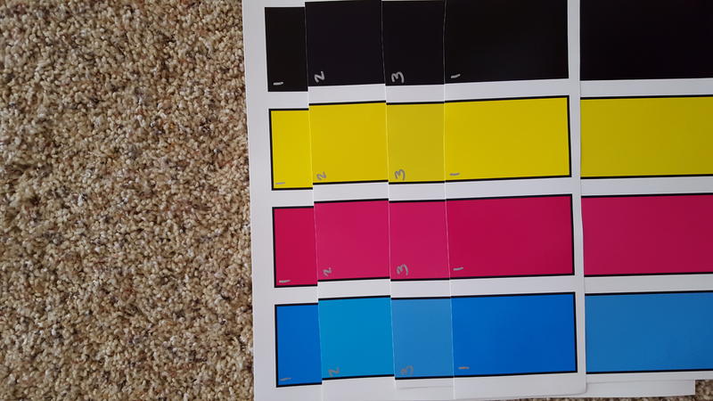

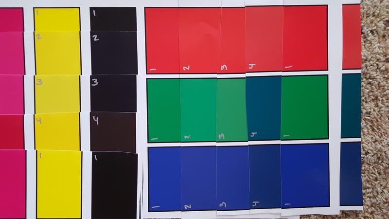

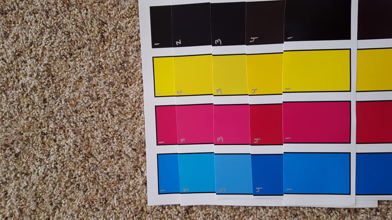

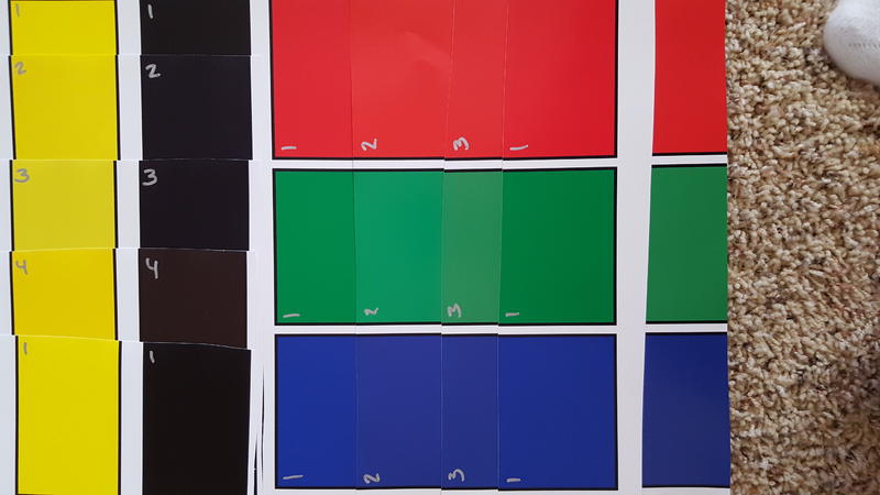

Here are the samples. (I hope the pictures show up) the ones labeled 1 is opening the file as the pdf in the rip software and turning all ICC profiles off (colors look amazing to me). The colors labeled 2 are the same pdf with running the rip colors as normal. The number 3 samples are downloading to photoshop flattening the image as I normally would and printing as I have been. The number 4 sample is through photoshop with the ICC profiles turned off. 20151121_133705.jpg 20151121_133727.jpg
All right, now we're getting somewhere. The samples that have color management disabled are a lot more saturated than the ones with it on. This looks to be the case with both vector and raster data sets, with the Photoshop files being raster and the original PDF vector. To an extent this is normal, but the color difference should not be as pronounced as it seems to be in this case.
This tells us that the various color settings in the RIP are responsible for the majority of the difference between samples 1 and 4 (CM off) and 2 and 3 (CM on in the RIP). I will set-up some screen captures of some recommendations for configuring your Onyx QuickSet(s). What media product are you printing onto (Manufacturer and product), and where did you obtain the OML (Onyx Media Library) that is being used in printing to that media? Can you locate the ICC Profile that is being used by the RIP? It is typically located in the following location:
