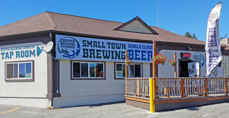

Here is a 4x20ft. print I just laminated, mounted and installed. Two-color Pantone match on Clear Oracal Vinyl, (swept off the dust and sent through the laminator) then applied to white Polycarb.
Sorry it's a little longer than 3 feet but somehow it worked out fine :)
You would have saved about $5 of ink on this ( $2K) job using the 360 over the 110. I can take $5 off my bid and still win, haha. Hope that micro-managing pans out for you.

Whatever works for you. I'm glad your happy with it, good luck!
