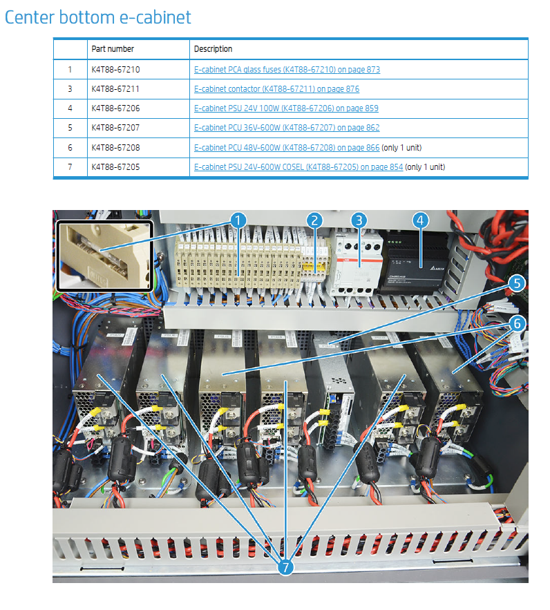

For those out there....PSU's in the E Cabinet and ALL of the solenoids/ink lines connected to the ink boxes (opposite side) were submerged. Anyone have a line on those part #s and how to acquire them? I know there are a couple HP people here whom are very knowledgeable. Thinking the printers overall are not toast...just those particular assemblies.

Just be so completely sure you don't have anything else that was effected. As you know otherwise you risk breaking your new parts as well.
All the connectors.. every board... anything that has electricity and has touched water can still hold water.
There is also stuff in the middle bottom beam, under the plastic shields. Check that also.
And triple check the computer side next to E-cabinet, behind the printer.
You don't need the solenoids any longer. Just remove them and put a straight connector (K4T88-67289) to their places. Remove the cables as well.

You are the man! In the photo...#s 5,6 & 7 were wet. Computer box on the backside powers up...but get the "e box connection error" due to the PSUs being shot.
Not sure what you mean by I don't need the solenoids....arent they regulated by the computer to allow ink to flow, etc?

No, it's a rework to remove the solenoids. Printer doesn't use them any longer.
Just remove them and connect the tubes together. Nothing else needed to be done.
