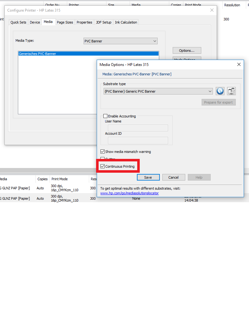

Depending on the firmware-version of your printer and the onyx version (it will work with 12, not shure about 11), you can select an option named "continuous printing" in the media options. Then it will print continuously without drying pauses.

FrankW
See attached screendump. But this is 12.2, could be that this option is not available in 12.0.x
Thanks again FrankW. It turns out this option is not available on version 12. I will check Onyx to see if there is a software update. Thanks again for the help with this matter..I was praying that option was available then :(
