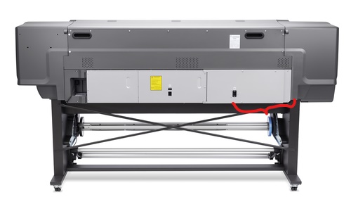

I'll leave you an image so you can see where is it located.
22150858_1865447732_LI.jpg It's located under that cover I pointed for you in red.
