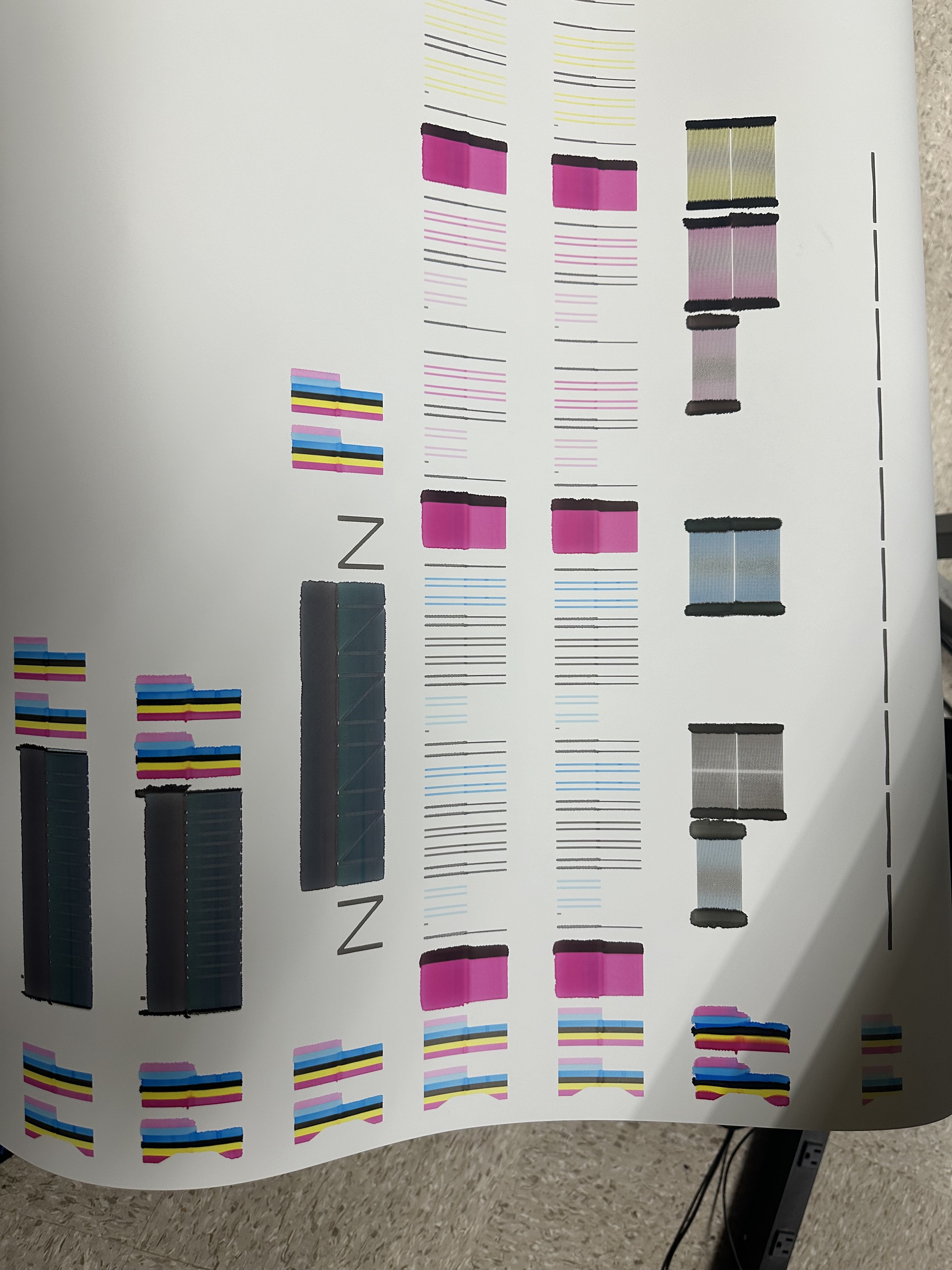

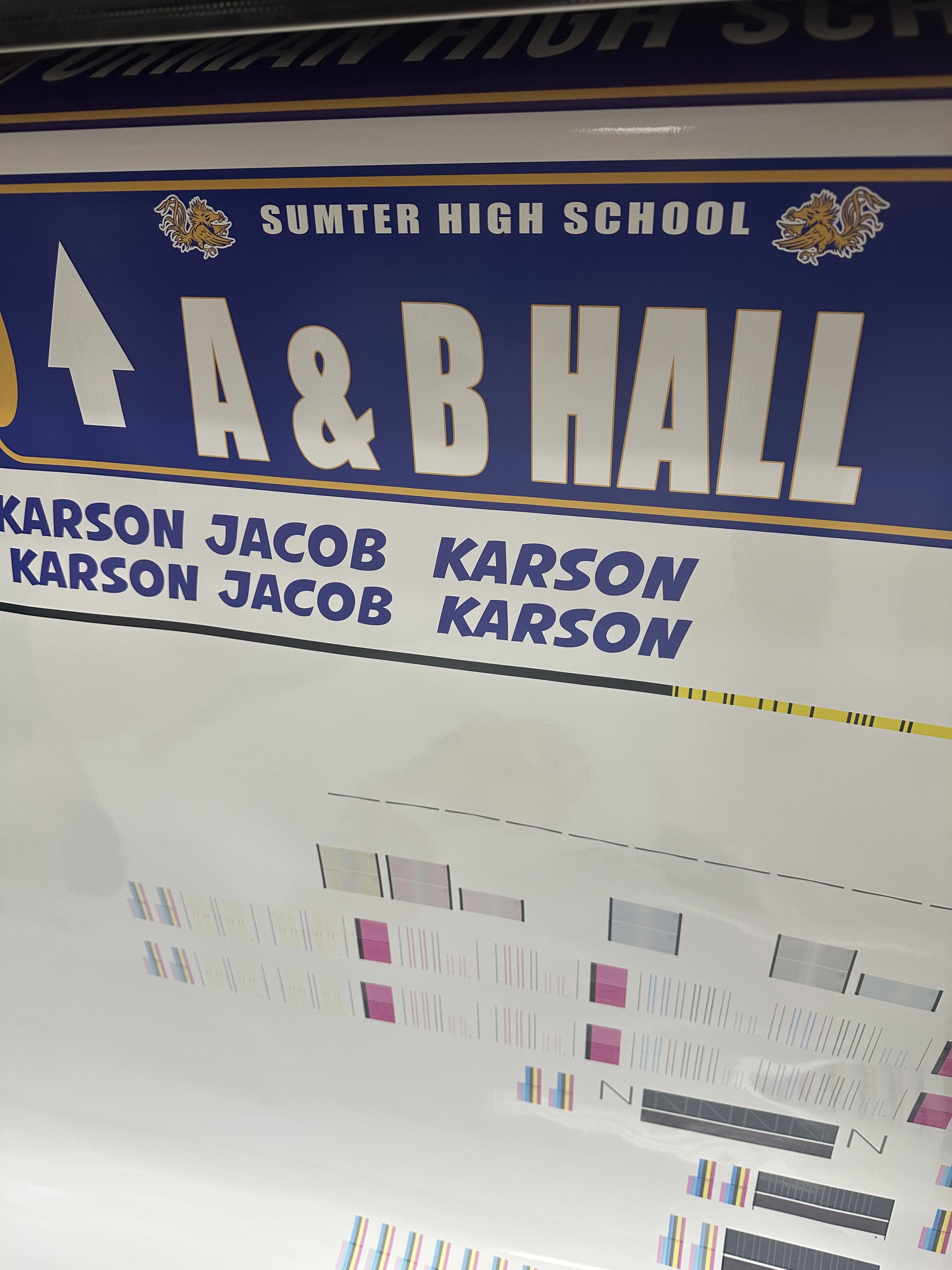

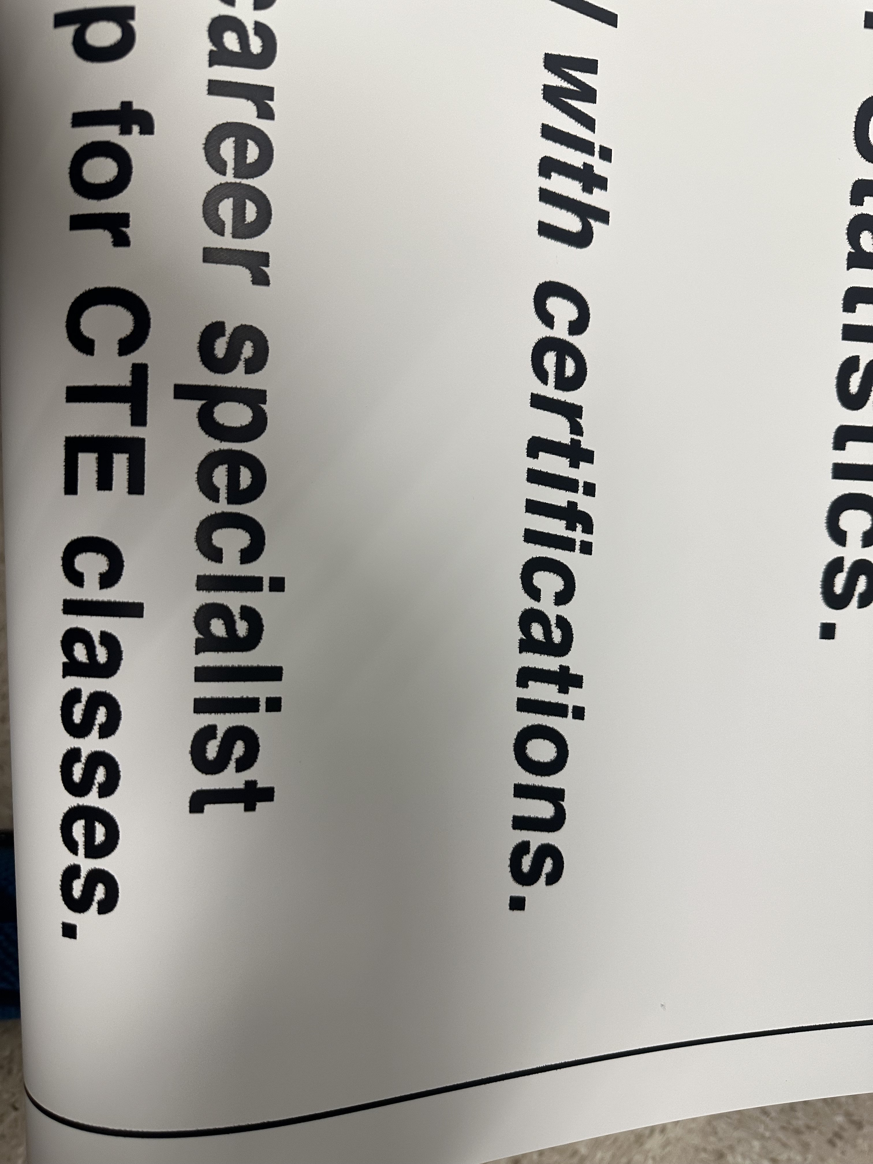

Follow up on my situation: This morning, I installed new printheads across the board, including the OP. As soon as I was done loading, the printer did its alignment etc. I still had the Briteline Rollup media in and the results were horrendous to say the least. First two images below are on the rollup media.
Strange as it may seem, I printed all day every day last week with Duratex vinyl banner and Duration X Adhesive Vinyl - never had any of the blotchy text etc. To test my printhead switch, I reinstalled the Duration X vinyl and did a few prints - looks flawless - none of the blotch or anything,
The profile I am using for the Briteline Rollup is the same profile I've used for several rolls of the same media in the past. Seems like this happens to me a lot - use a product and profile without issue and then all of the sudden - it doesn't work (happens now with Mesh banner)
Anyhow, I've seen some of the posts before this reply and there's mentions of more heat, slower, add a delay, etc. I'm still in the "learning" stage, so if one of y'all could give me some pointers on what to do and how, or point me to a better profile, I'd sure appreciate it.
Many thanks in advance!
