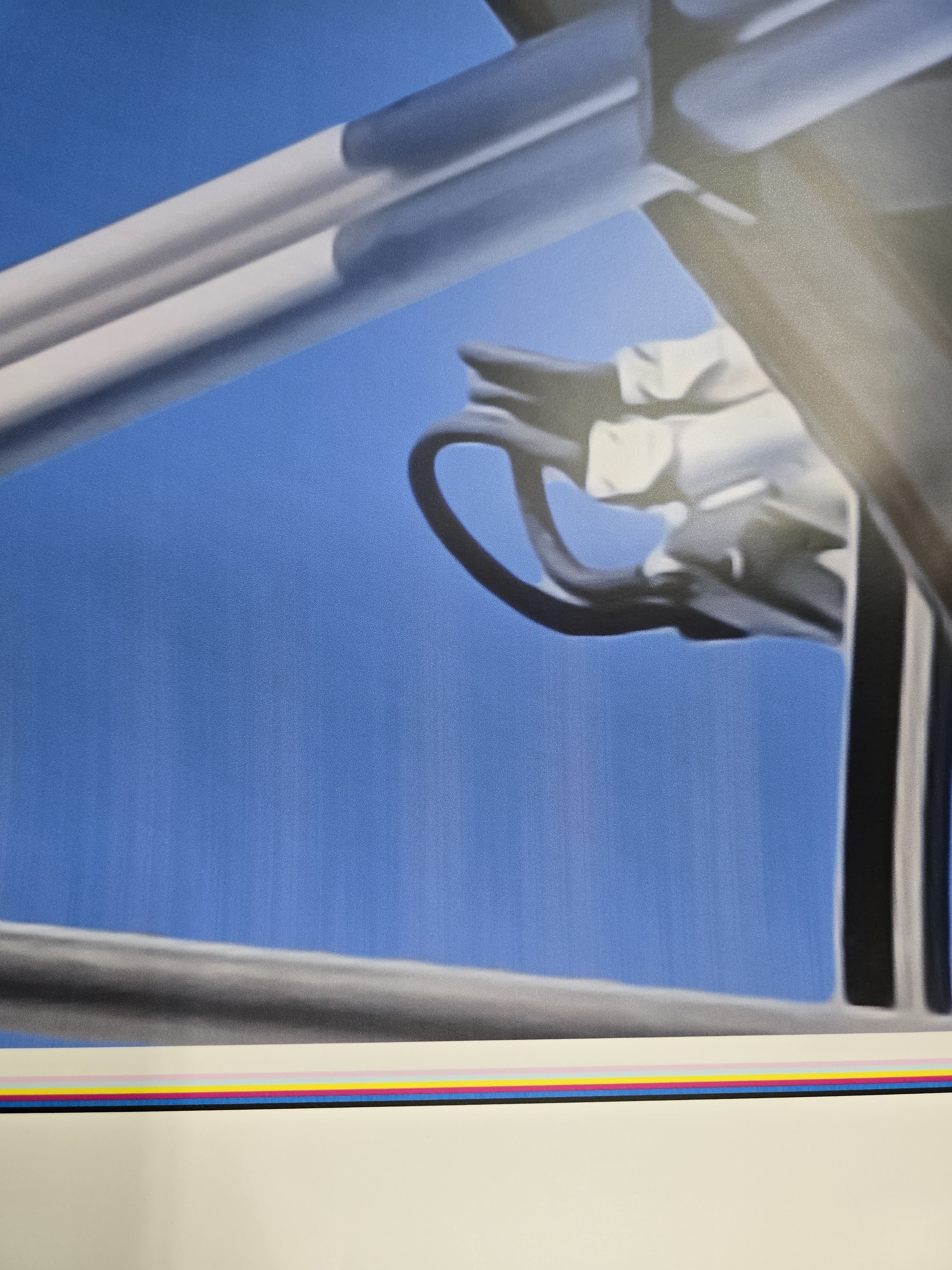

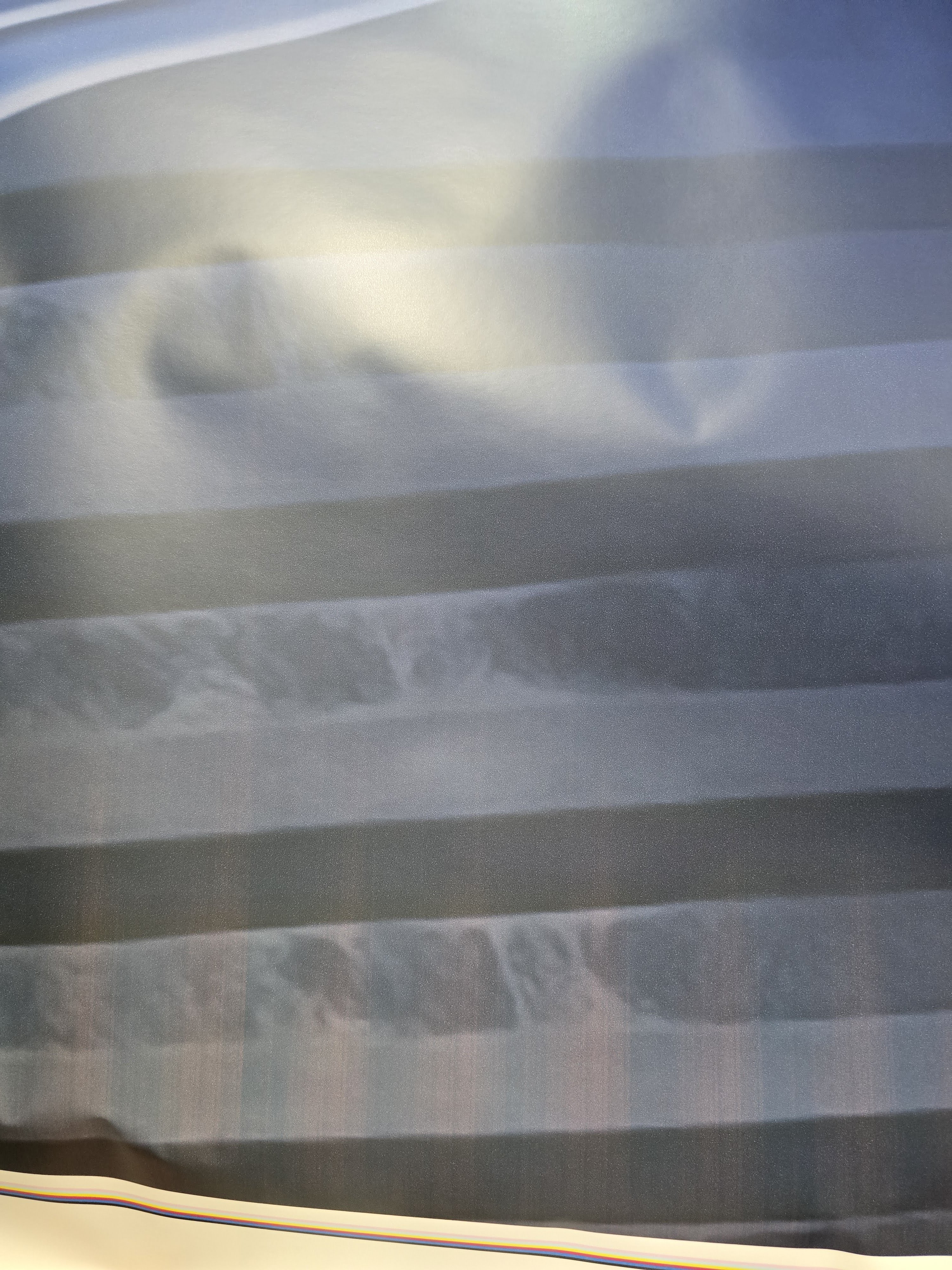

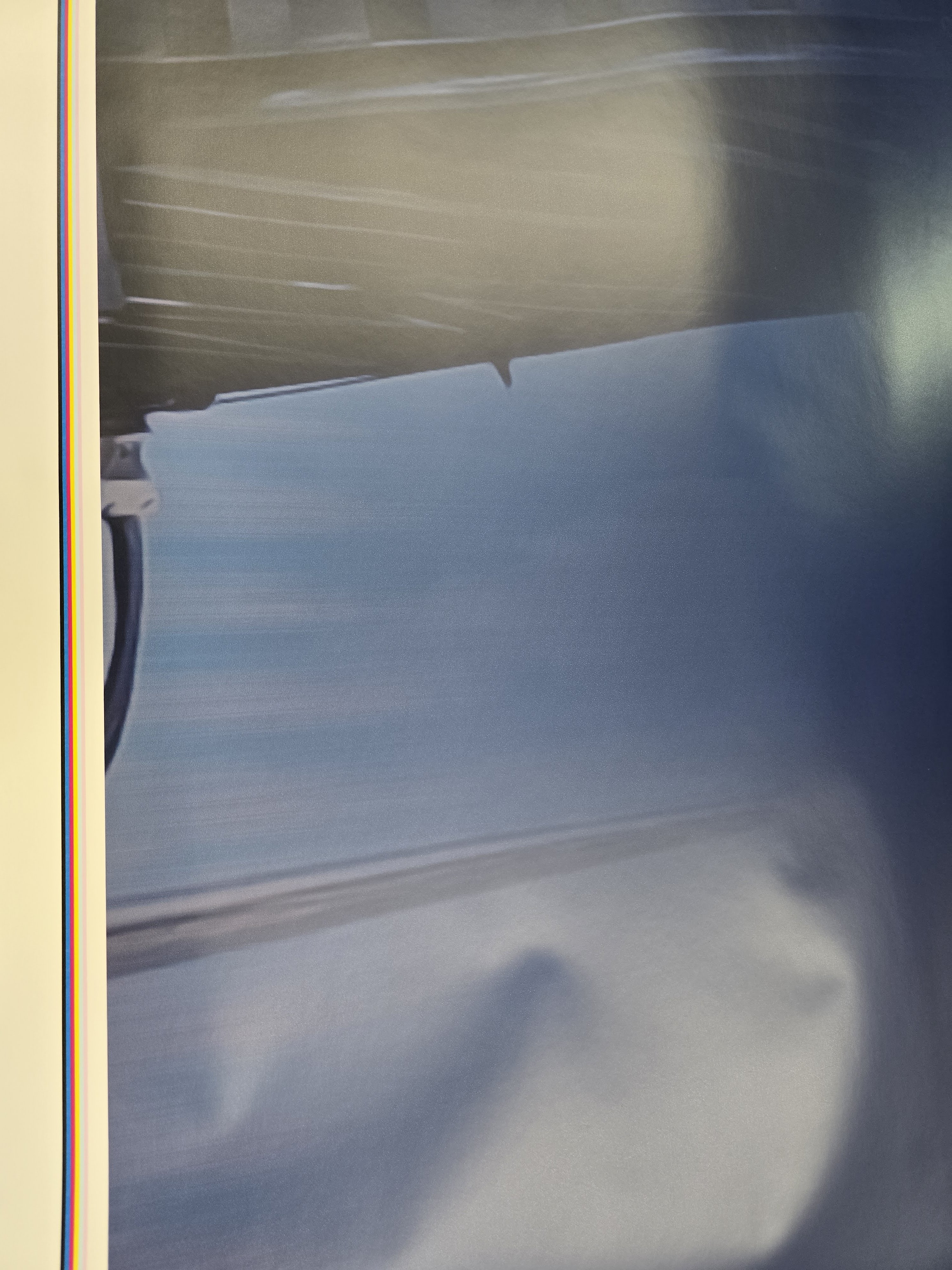

I’ve been running into some issues with a few prints—specifically those with heavy ink coverage (though not flood black). The problem only shows up on one side of the print.

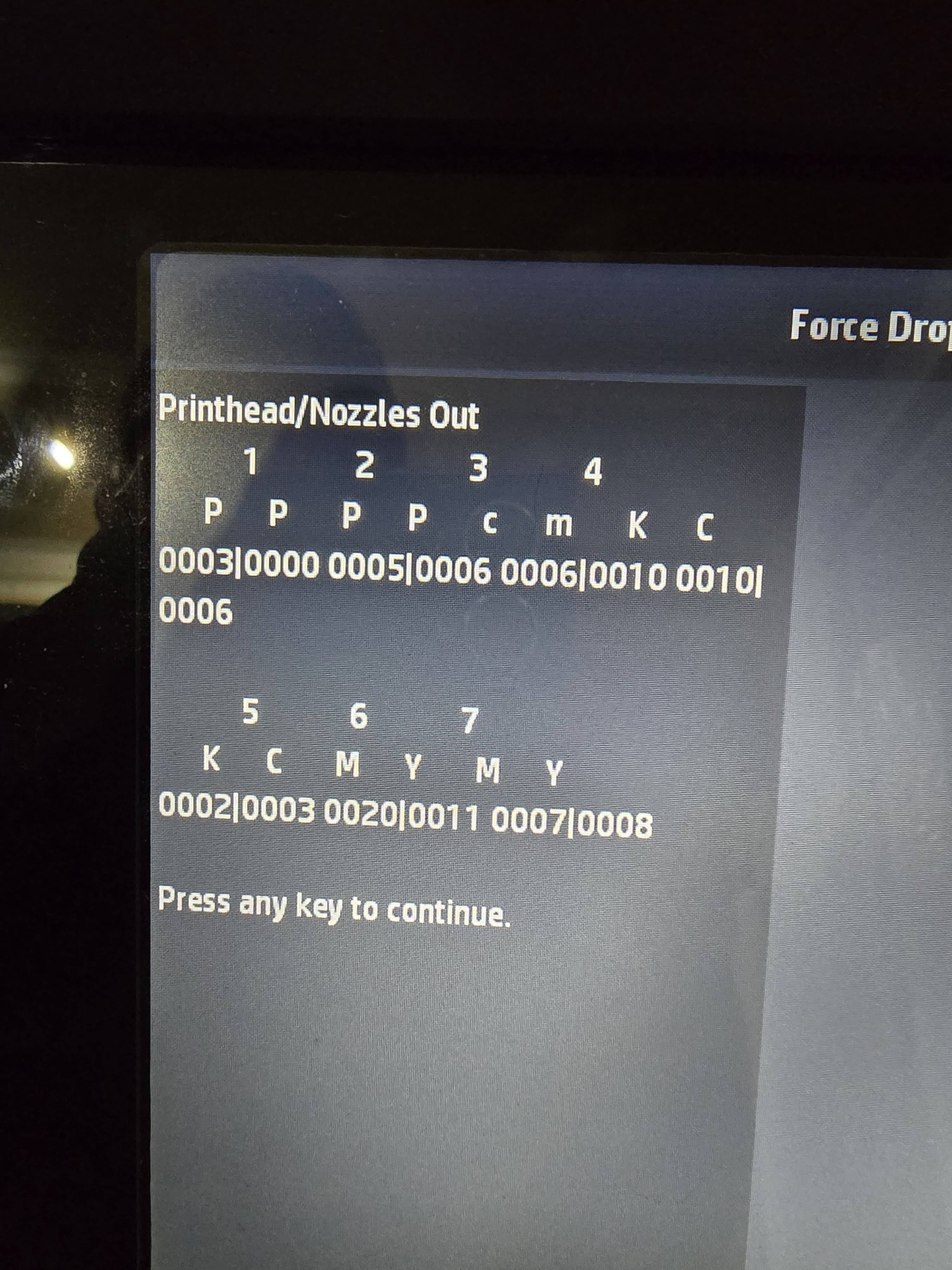

I’ve already performed a color calibration, a force drop test, and checked the printheads for proper ink firing. I know this is a fairly common issue, but I haven’t been able to find a solution yet.
Any advice would be greatly appreciated!

Solution is to replace printheads. Maybe you see a common color so that tells you which ones.
Fbermudez
check the wiring on the print heads, I had a head strike and after it started doing something similar and it ended up being that on the head strike it damage the strip on the one of the heads.
