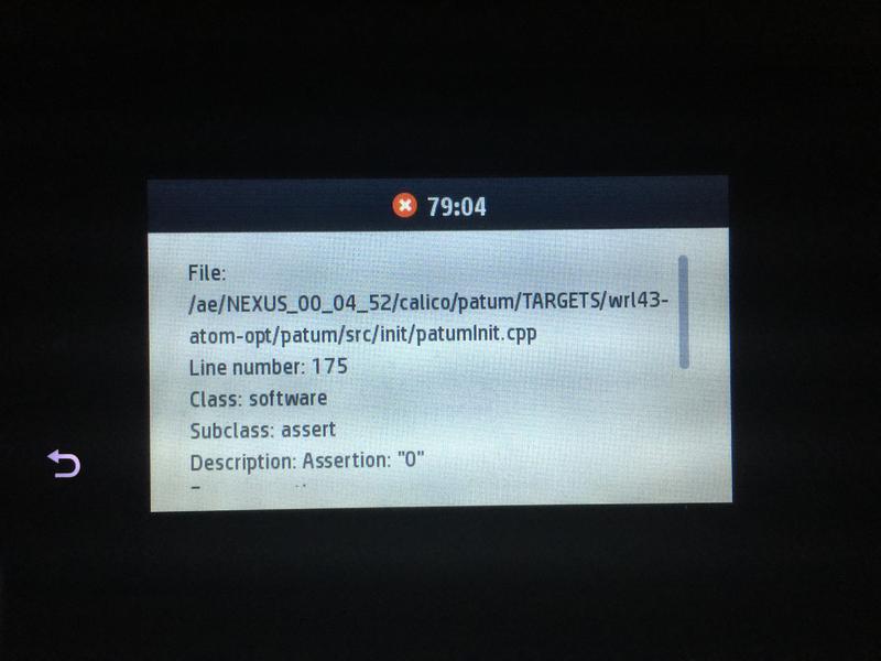

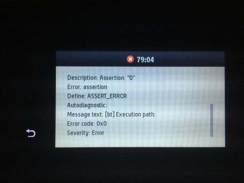

HP support is closed until after the holiday. I'm hoping someone could point me in the right direction. I've tried to color calibrate my printer, twice over Flexi v12, and two attempts directly from the printer setting menus. The printer will print the test pattern and stop at the same place every time.
I have tried re downloading the firmware and it has not helped. I will post attachments in the next post.

I own the 110.

Ragnabrok
Most solutions point to doing an EPROM reset, and failing that a reset to defaults. usually a hardware fault will give a specific failure to that component.
Updating the firmware from a USB stick or the web server could also help.
FrankW
Hi folks,
79:04 is a generic firmware error. Common corrective actions are suggested: rebooting the printer (switching it off at the back, disconnect and reconnect cables), check firmware version and so on ... if it continues, a service engineer should check the harddisk.
jdejesus
Thanks for taking the time to give feedback. I tried them all and none of it worked. Called HP tech support and over the phone we were able to figure out it was a bad profile I was using. Started from scratch from the generic profile and I was up and running in no time. :rock-n-roll:
