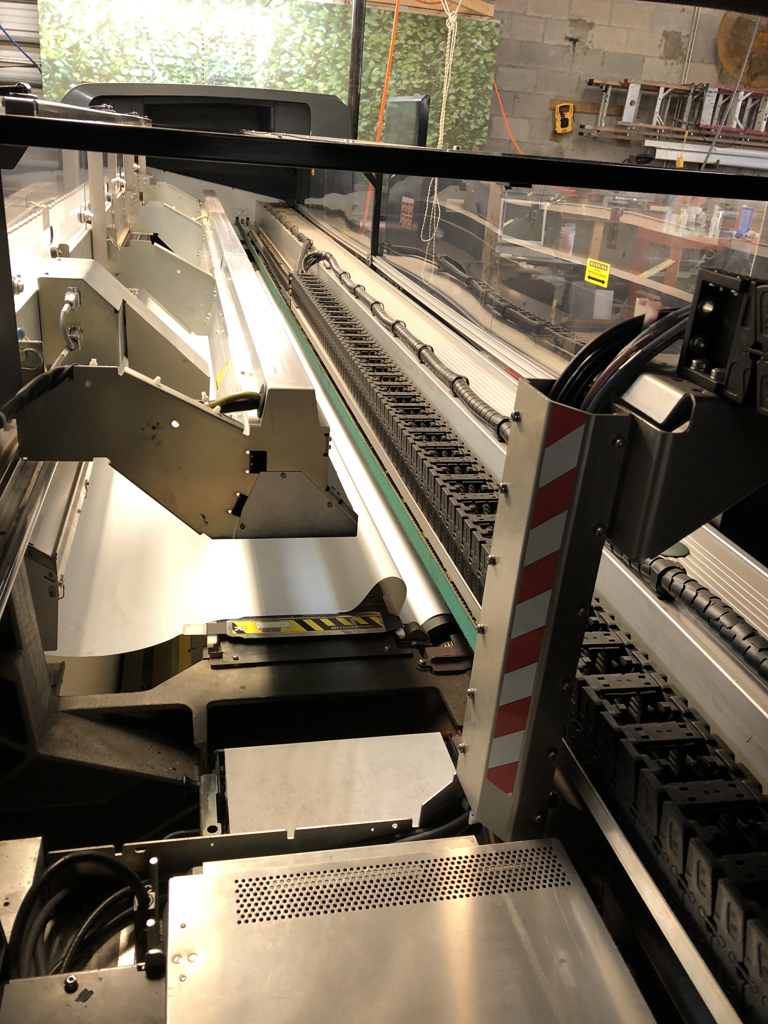

We have problem when we sent something to print because the main roller move the media forward back the take up roller don’t pulled the media causing a bump we get a Head Strike

The printer is not new, we were working ok with the 63” media but when we change it for 126” media started the problem after we loaded the material when we sent to printed the test or a file
I will try it to sent a picture of the problem
