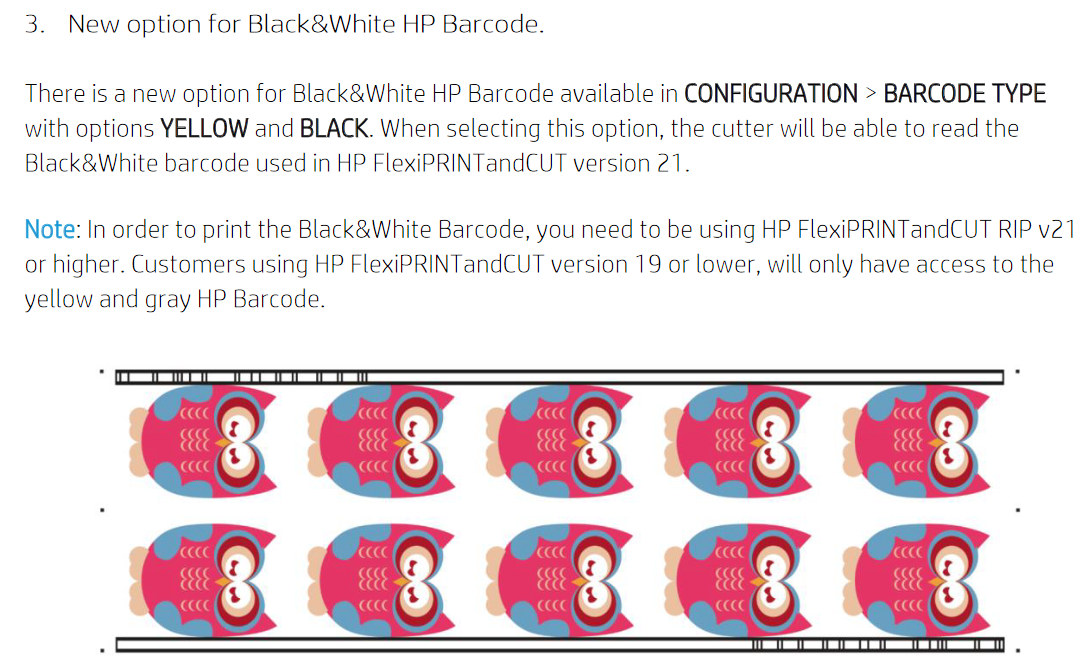

And after you upgraded your firmware, are you sure the cutter is still set for the correct barcode?
There's two styles now.
Thank you balstestrat - did not know that about the 2 types of barcodes, but I am using HP Flexi 19 - I did upgrade at one point to v22, but all previous settings, ICCs etc just went POOF! and was too backed up to figure it out, so just reverted back to what I knew/learned on - 19.
