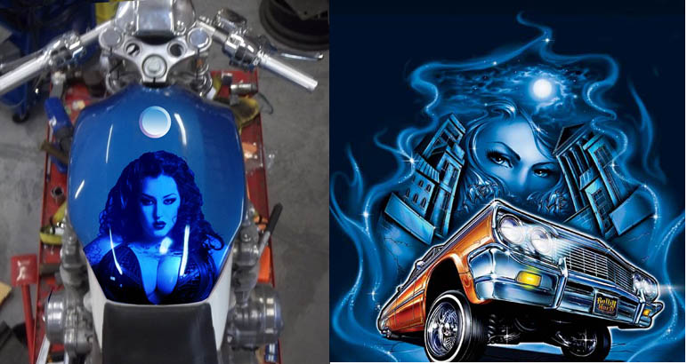

Pretty much right on the money, we've ended up doing some wide stripes length wise on the tank and fenders, all done with different base coat colors and flake that will all be top coated in Tangerine candy. The overall color scheme is still all orange flavors. We are shooting the parts now, so everyone suggesting what we should use for the print part is a huge help.
The bike has an adult theme and the topless plan -when I tell people I'm putting the wife on the bike topless, I either get big grins, or a total look of disgust. Pretty amusing... It is a drawing after all, even though the artist was instructed to draw the bust exactly like the real set, he as my wife said when she saw the final artwork "look he gave me a boob job for free!".
On the 2mil vinyl, would it be flexible enough to wrap slightly over on the sides of the tank? The tank narrows where the bust falls, the original plan was to go as large as possible with the image and let the bust flow over and onto the sides just a small amount. I even relocated the fuel cap and added length to the tank at the front of the seat to gain more room for the art.
I'm attaching an early photoshop version we did to help everyone to visualize the look we are after. Now we want to be able to take the bike to shows and such, so we either have to hide the R rated portion of the bust or come up with a way to cover the nipples when in a family atmosphere. The wife said she'd just make a leather tank bra that we could attach over the art for that needs. She would just make it look like a bustier top similar to what is shown on the girl in the photoshop image. I've also attached a image with the airbrush effect, that I'll probably use to hide the vinyl edge. The car in the image would represent the printed portion of the art in our case. The wispy and sparkly part would do the job I think in hiding the edge pretty well.
So the real question now is can the material be wrapped slightly, and if so, then we can go large, if not then we'll have shrink the image size to fit on the top of the tank surface only.
Thanks again for all the help on this!
