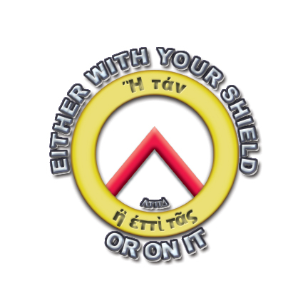

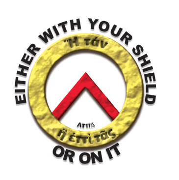

The design...
GK

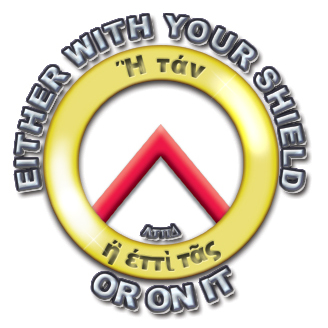

if i may make a suggestion to you Kevin, make a selection of the circle only (the first one) and touch it up with the "Color Dodge" tool on the upper right and lower left. This will make it look like light is hitting it and make it look like a metal because of the shine =)

I like what you did with that George - cool effect
Sign_Boy
I must be dumb I can't figure out that tool, all these years and I never used it ever:help:
